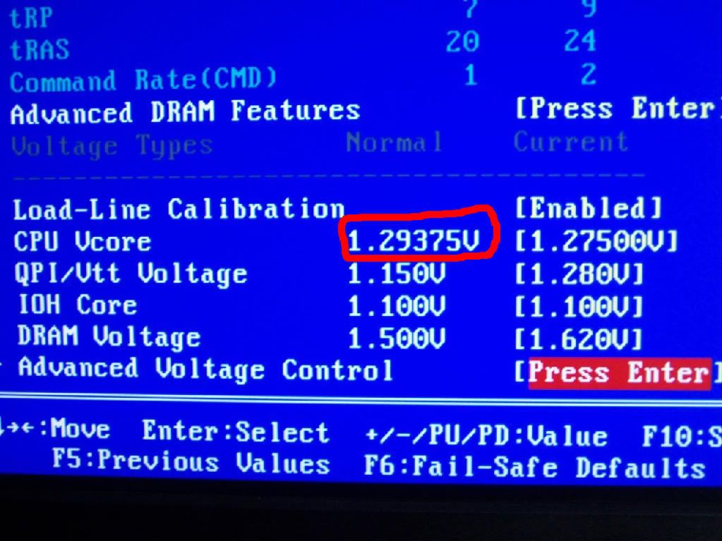

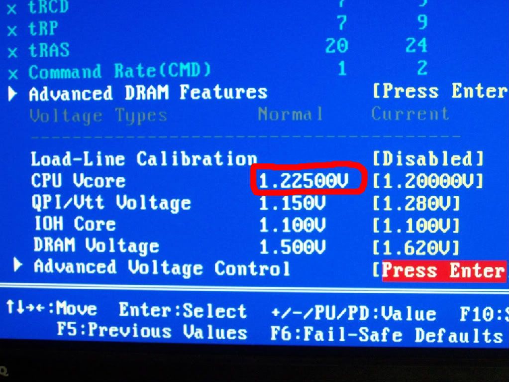

Can anyone tell me why what I had assumed is the default vcore for my 940 keeps changing it's value? I thought it was meant to be a reference to the stock voltage?
Only thing that has changed other than my manual voltage in each pic is HT and LLC. First I thought it was a result of turning those on/off, but it seems much more random than that.

@nipper575, first picture is with Turbo Disabled, second is with Turbo Enabled, when you enable Turbo it will raise your vcore
Really, I didn't think I touched turbo mode, I'll try it now.
thanks.

@nipper, mine does the exact same when I disable turbo boost tech in the BIOS.

Thanks guys, after playing around with the settings, turning turbo on and off did indeed change my default vcore. I think there must be other contributing settings also as by turning turbo off only dropped my default vcore to ~1.265v, not the 1.225v it did in the picture, just a matter of seeing what I had turned on and off in the bios...
Thanks guys.
