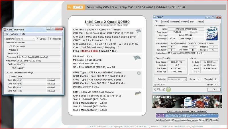

Current settings are below. Running my Q9550 at 3.6Ghz with less voltages than the actual VID, done 4hrs prime blend stable which is plenty for me. CPU seems stable at 4Ghz with 1.257v but aint been able to get the rest of the system stable yet.
Any advise or input on how to tighten up these memory settings would be greatly appreciated.
http://i38.photobucket.com/albums/e1...hzvalidate.jpg
Code:AI Overclock tuner: Manual
CPU Ratio Setting: 8.5
FSB Strap to North Bridge: 333
FSB Frequency: 425
PCI-E Frequency: 101
DRAM Frequency: 1021Mhz
DRAM CLK Skew on Channel A1: AUTO
DRAM CLK Skew on Channel A2: AUTO
DRAM CLK Skew on Channel B1: AUTO
DRAM CLK Skew on Channel B2: AUTO
DRAM Timing Control: Manual
1st Information :
CAS# Latency: 5
DRAM RAS# to CAS# Delay: 5
DRAM RAS# Precharge: 5
DRAM RAS# Activate to Precharge: 15
RAS# to RAS# Delay : 5
Row Refresh Cycle Time: 55
Write Recovery Time: 9
Read to Precharge Time: 5
2nd Information :
READ to WRITE Delay (S/D): AUTO
Write to Read Delay (S): AUTO
WRITE to READ Delay (D): AUTO
READ to READ Delay (S): AUTO
READ to READ Delay (D): AUTO
WRITE to WRITE Delay (S): AUTO
WRITE to WRITE Delay (D): AUTO
3rd Information :
WRITE to PRE Delay: AUTO
READ to PRE Delay: AUTO
PRE to PRE Delay: AUTO
ALL PRE to ACT Delay: AUTO
ALL PRE to REF Delay: AUTO
DRAM Read Training: Disabled
MEM. OC Charger: Disabled
AI Clock Twister: Moderate
AI Transaction Booster: Manual
Common Performance Level [10]
Pull-In of CHA PH1: DISABLED
Pull-In of CHA PH2: DISABLED
Pull-In of CHA PH3: DISABLED
Pull-In of CHA PH4: DISABLED
Pull-In of CHB PH1: DISABLED
Pull-In of CHB PH2: DISABLED
Pull-In of CHB PH3: DISABLED
Pull-In of CHB PH4: DISABLED
CPU Voltage: 1.2275
CPU GTL Voltage Reference (0/2): 0.670
CPU GTL Voltage Reference (1/3): 0.670
CPU PLL Voltage: 1.56
FSB Termination Voltage: 1.26
DRAM Voltage: 2.00
NB Voltage: 1.26
NB GTL Reference: 0.640
SBridge Voltage: AUTO
PCIE SATA Voltage: AUTO
Load Line Calibration: Enabled
CPU Spread Spectrum: Disabled
CPU Clock Skew : Normal
NB Clock Skew : Normal
Advance CPU Settings
C1E Suppport: Disabled
Max CPUID Value Limit: Disabled
Intel® Virtualization Tech: Disabled
CPU TM Function: Disabled
Execute Disable Bit: Disabled
