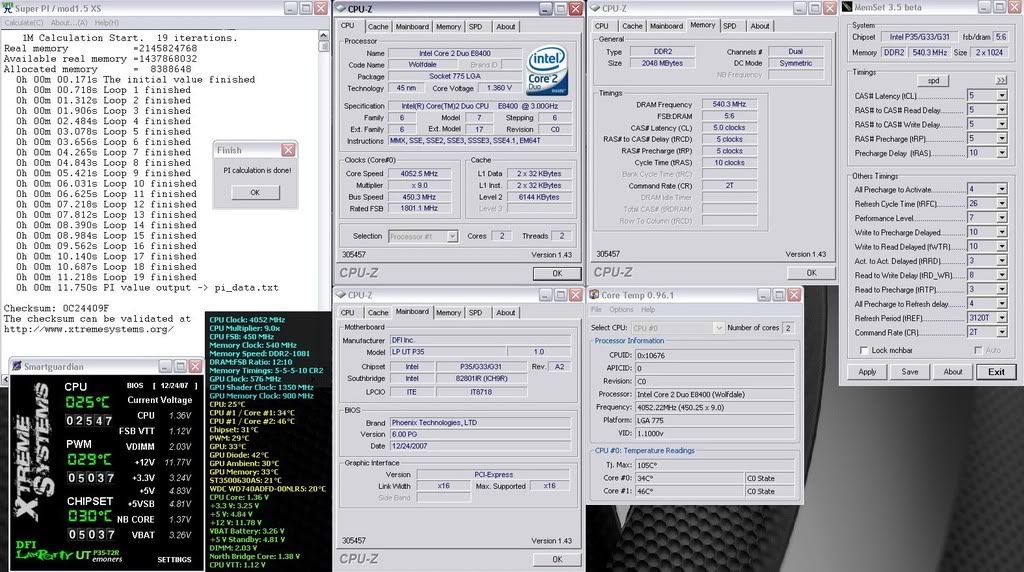

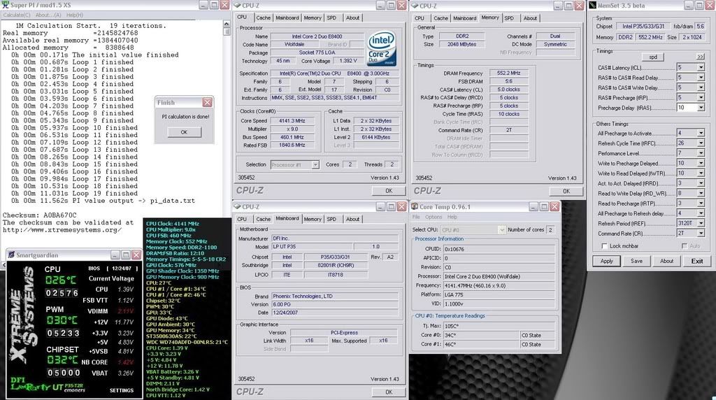

As per my request for info from all of you, here is my Prime 95 4 hr stable settings as of last night.
http://img89.imageshack.us/img89/782...458mfh3.th.jpg
I am using the 11/07 BIOS, with 1.4 vCore, 1,55 NB Core, 1.6 FSB VTT, and CPU GTL 1/3=118, CPU GTL 0/2=116, andNB GTL=116.
For the record, I just wanted to note that this is a Q6600 B3 stepping CPU, with batch #L644G191. I believe that once I get water cooled, I will be able to run 8 x with 450-475 FSB (3600-3800 MHz). It is the exta heat of the B3 that is keeping performance down a bit. When I Prime 95 at my current settings, Core temp 0.96 is reading as high as 71 C (although it is typically 64-66 C)
