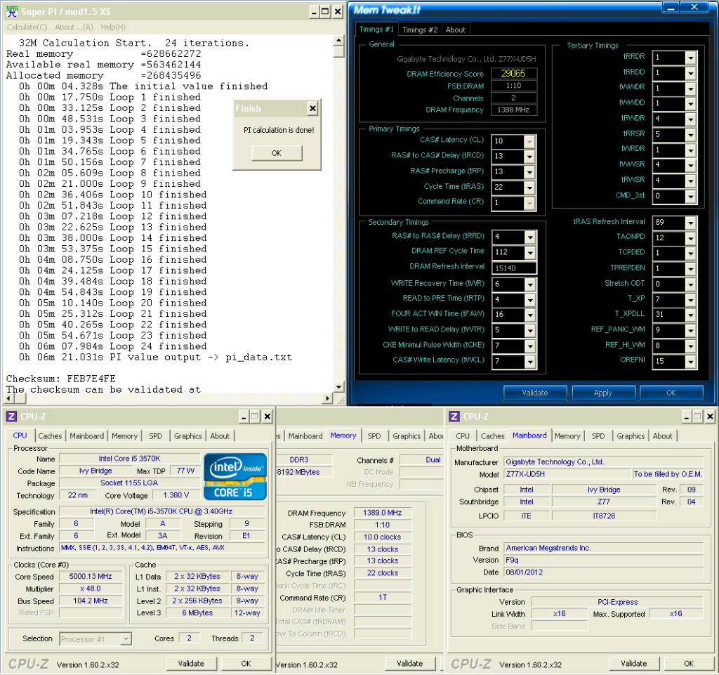

F9q thundering along just fine now :D
F9q appears to have slightly slower latency (.2~3) compared to F9o although its as fast in 32M if not faster. It also for me always fully powers off & restarts when making changes/rebooting where as F9o just boots. Oh & F9q has the internal pll button back that disappeared in F9o.
### EDIT ###
.005 extra vcore got rid of the hard reboots!!!
http://i106.photobucket.com/albums/m...6006m20594.png
http://i106.photobucket.com/albums/m...0594AIDA64.png
Tweaking my TeamX 2600 (PI32 pass).
Still in progress........

Mine are getting touchy now... could be IMC could be RAM still testing but past 2740 tRCD & tRP 12 is tough
13 runs fine though.
http://i106.photobucket.com/albums/m...8SlackTest.png
http://i106.photobucket.com/albums/m...TestAIDA64.png
