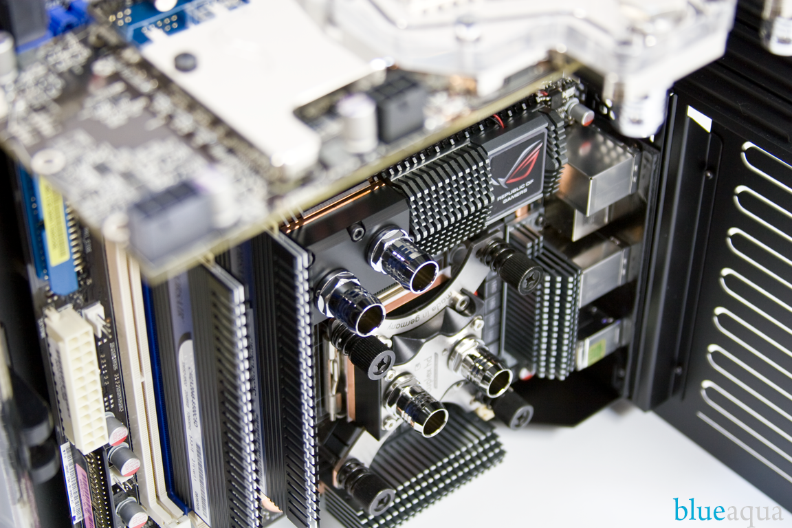

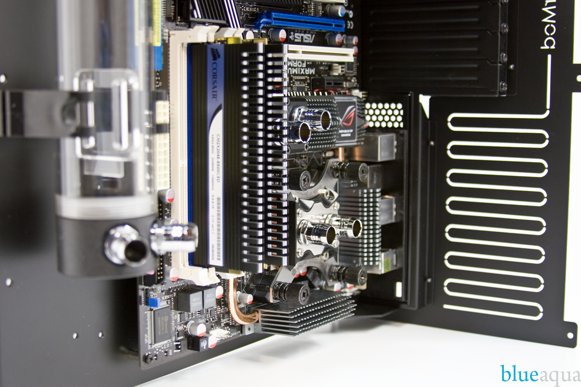

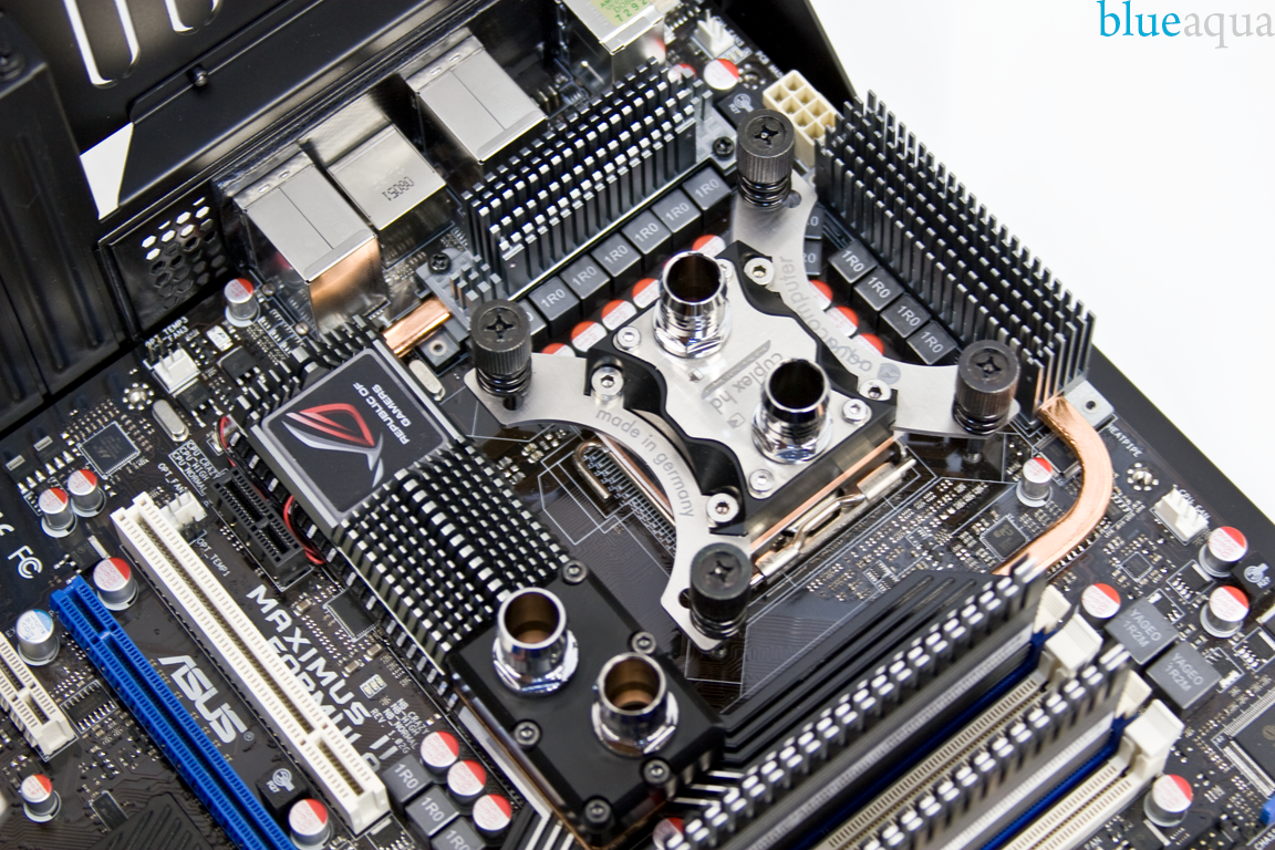

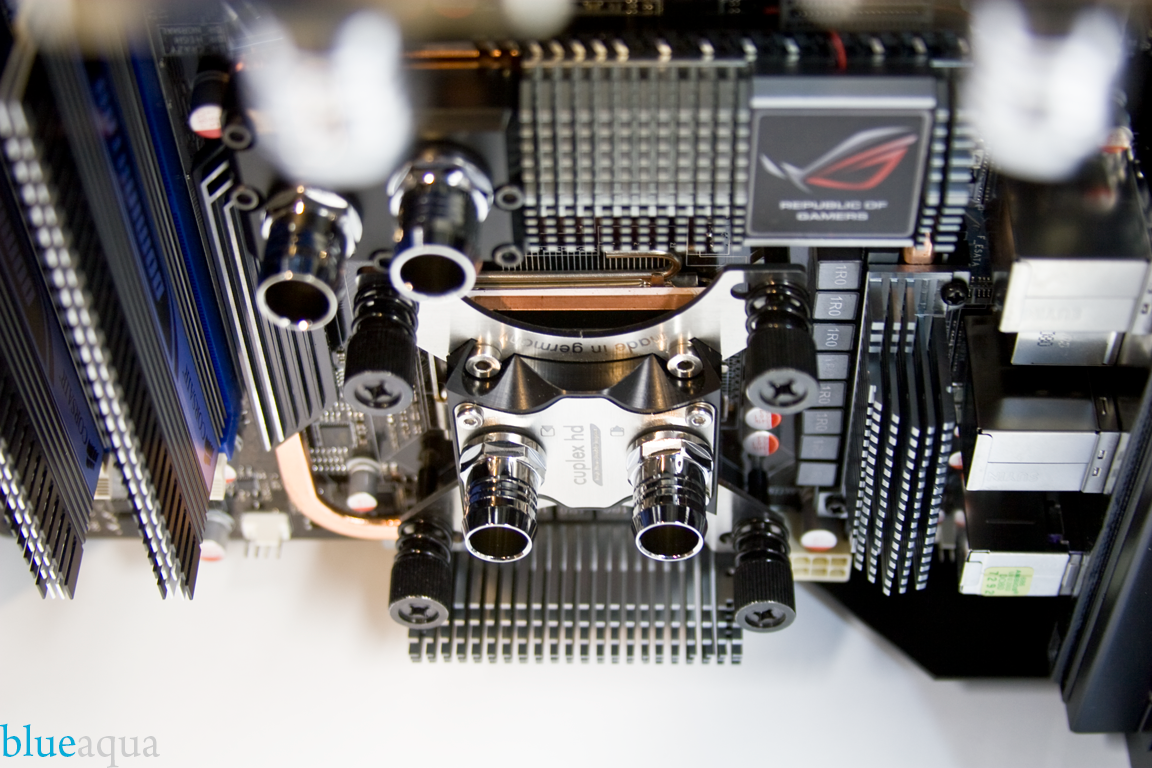

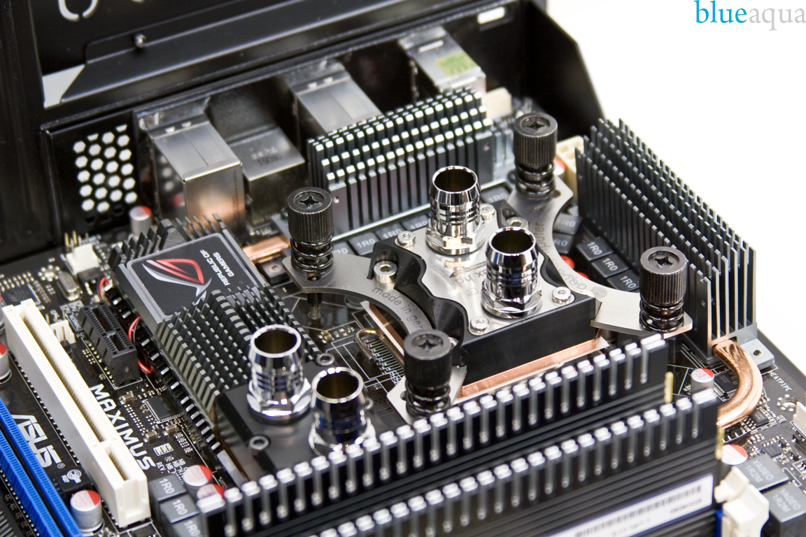

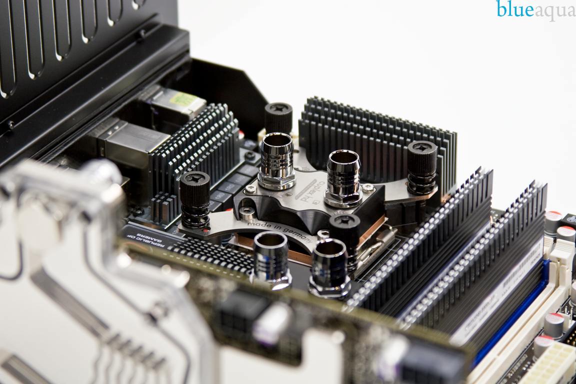

The fusion of this E X T R E M E L Y beautiful board and LC-setup with the case might create a black hole that sucks us all in ... but I am not afraid! :D
I have to agree with Dualbrain here, although unlike him I'm terrified.
We could all have our eyes sucked into our monitors by this amazing build :shocked:

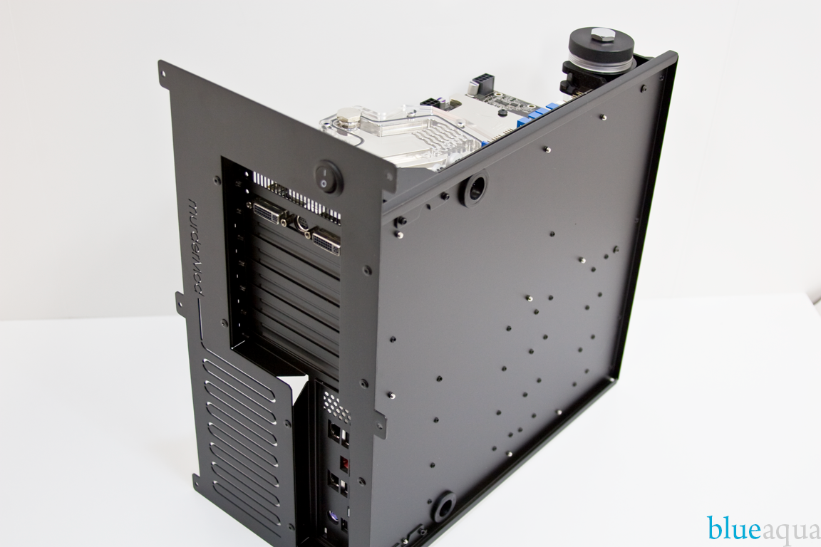

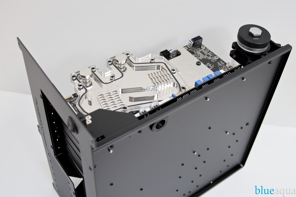

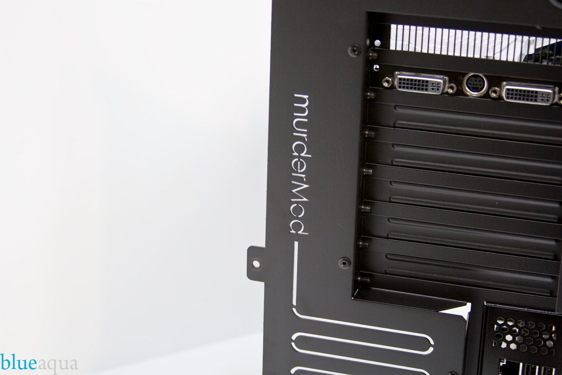

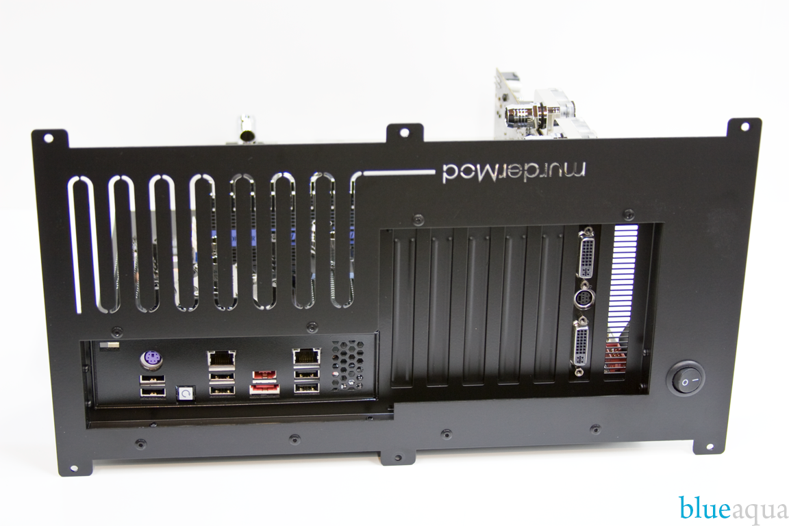

I'm sure you don't mind looking at a few pictures. I did it, I drilled through the beautiful midplate and I think it came out rather nice. Let me know what you think.
http://img.photobucket.com/albums/v2...a/IMG_2476.png
http://img.photobucket.com/albums/v2...a/IMG_2479.png
http://img.photobucket.com/albums/v2...a/IMG_2482.png
http://img.photobucket.com/albums/v2...a/IMG_2483.png
http://img.photobucket.com/albums/v2...a/IMG_2484.png
http://img.photobucket.com/albums/v2...a/IMG_2485.png
http://img.photobucket.com/albums/v2...a/IMG_2488.png
http://img.photobucket.com/albums/v2...a/IMG_2489.png
http://img.photobucket.com/albums/v2...a/IMG_2494.png
http://img.photobucket.com/albums/v2...a/IMG_2498.png

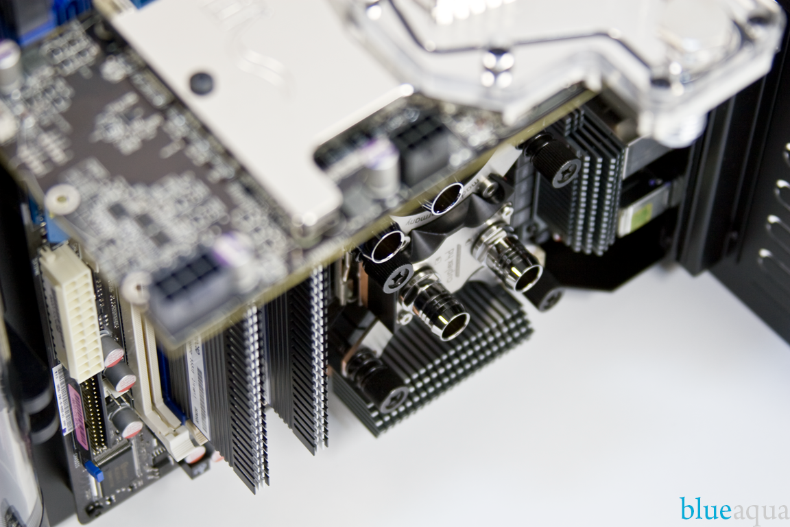

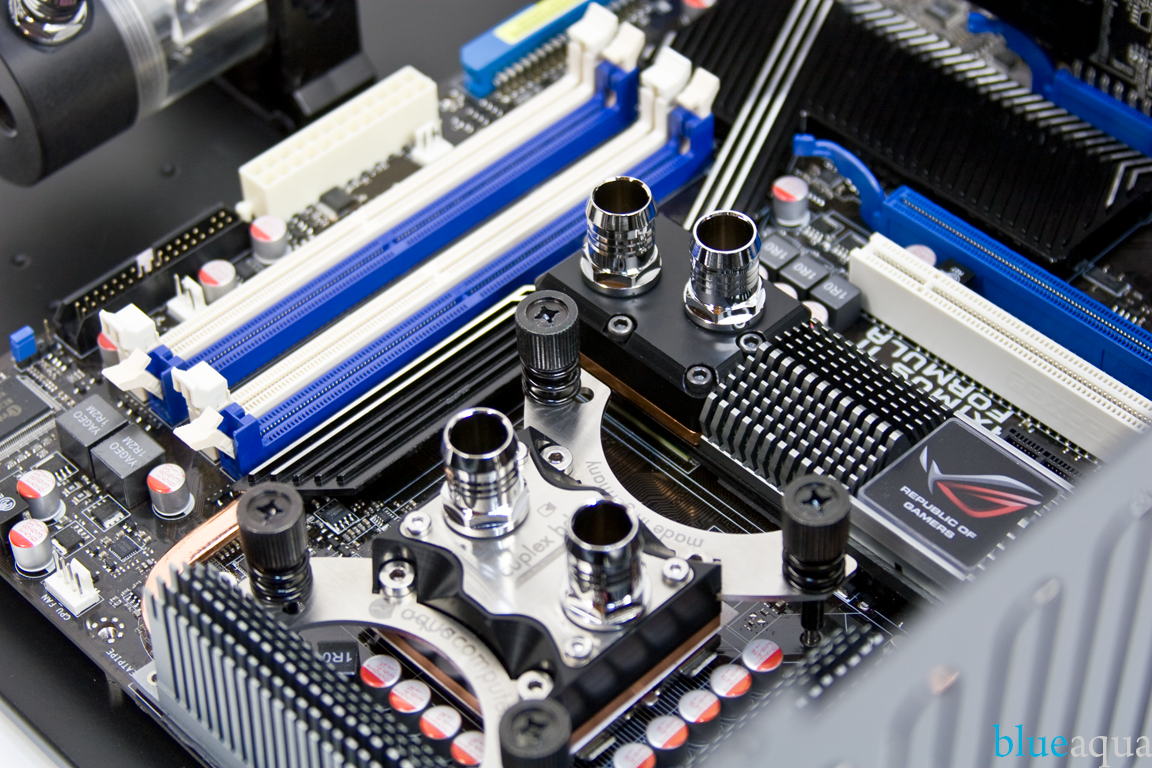

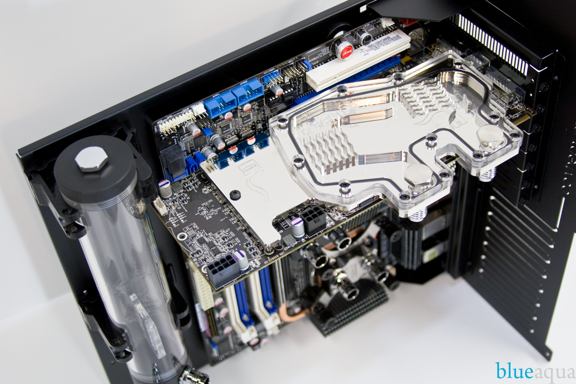

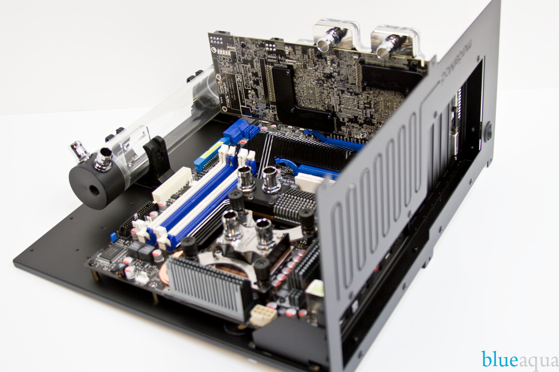

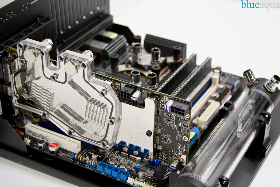

I'm just about ready to start the sleeving and cable management. I wanted to fit the reservoir and ensure that everything was going to fit as planned. There isn't much tolerance between the video card and res, it's tight.

thankyou for posting the pics of the res and the card! I desperately needed an estimate of the room I would have in my build with a 4870x2 and 2 EK res :up:

Nice cuts on the mid-plate :)

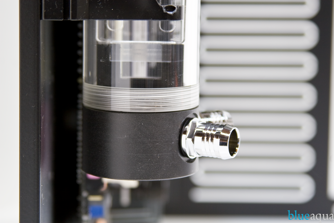

Is that the EK 400 reservoir??
looks like 250 to me :fact:
Definitely the 250.
Tubes BA, don't forget the tubes!:D
Nice stuff man
Yep, you guys are right, it's an Ek 250.

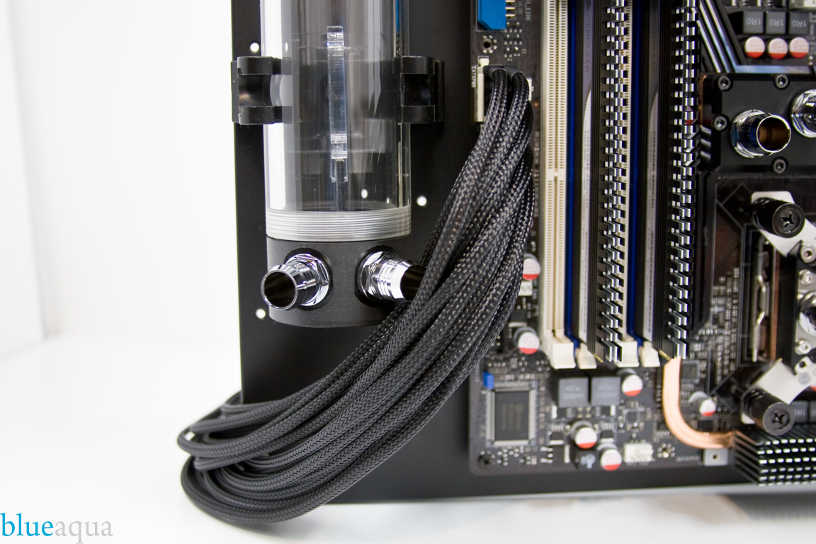

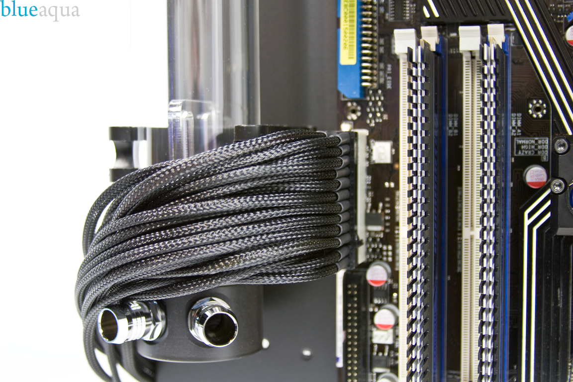

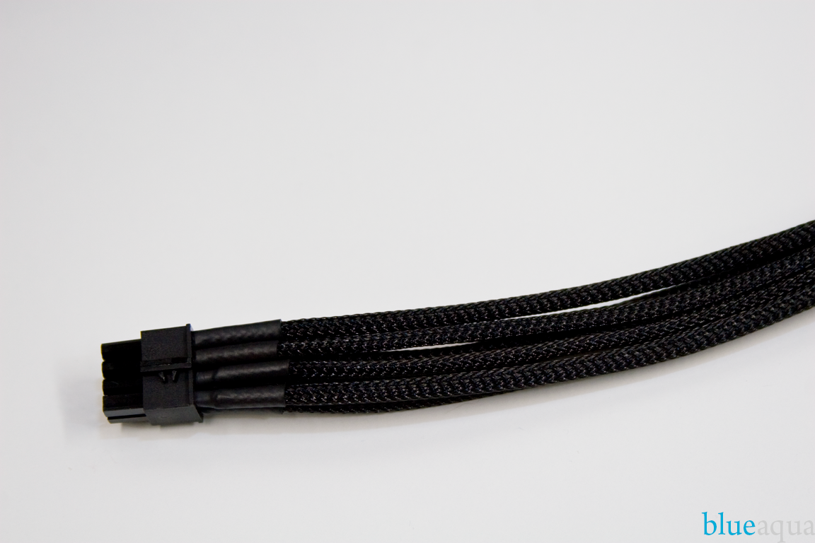

Twwen you weren't joking when you hoped I had steel fingers. I've been sleeving for hours and have a few sleeved cables and sore fingers to prove it.
I plan on air cooling this machine, no need for funky toobs. ;)

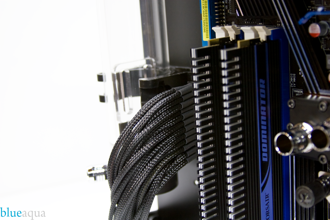

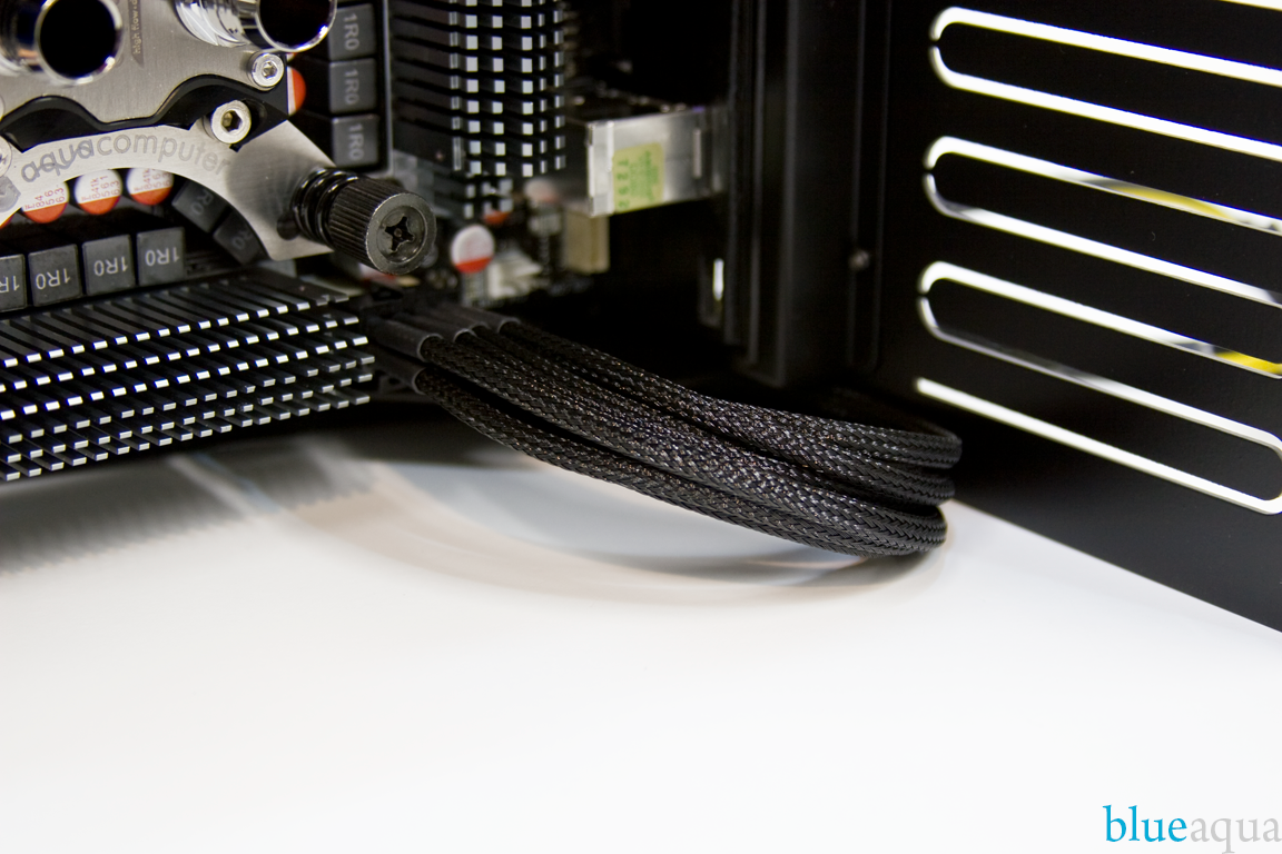

It's not a very exciting update, but at least it's progress. Here are two pictures of my sleeving process. I still need to sleeve the pci-e cables, but you get the idea.
http://img.photobucket.com/albums/v2...a/IMG_2523.png
http://img.photobucket.com/albums/v2...a/IMG_2525.png

awesome sleeving BA!
i have the hx1000 as well, but gave up on sleeving them directly because those pins were soooo tight.
but you did it man! very good job
:up:
I had a lot of trouble getting the pins loose with 2 different pin removal tools. I used Dangals staple trick with a pair of needle nose pliers and it worked out great. I was able to do it with the tools on another psu, but I'm not sure if the Corsair is different. It was very difficult until I went to the staple.

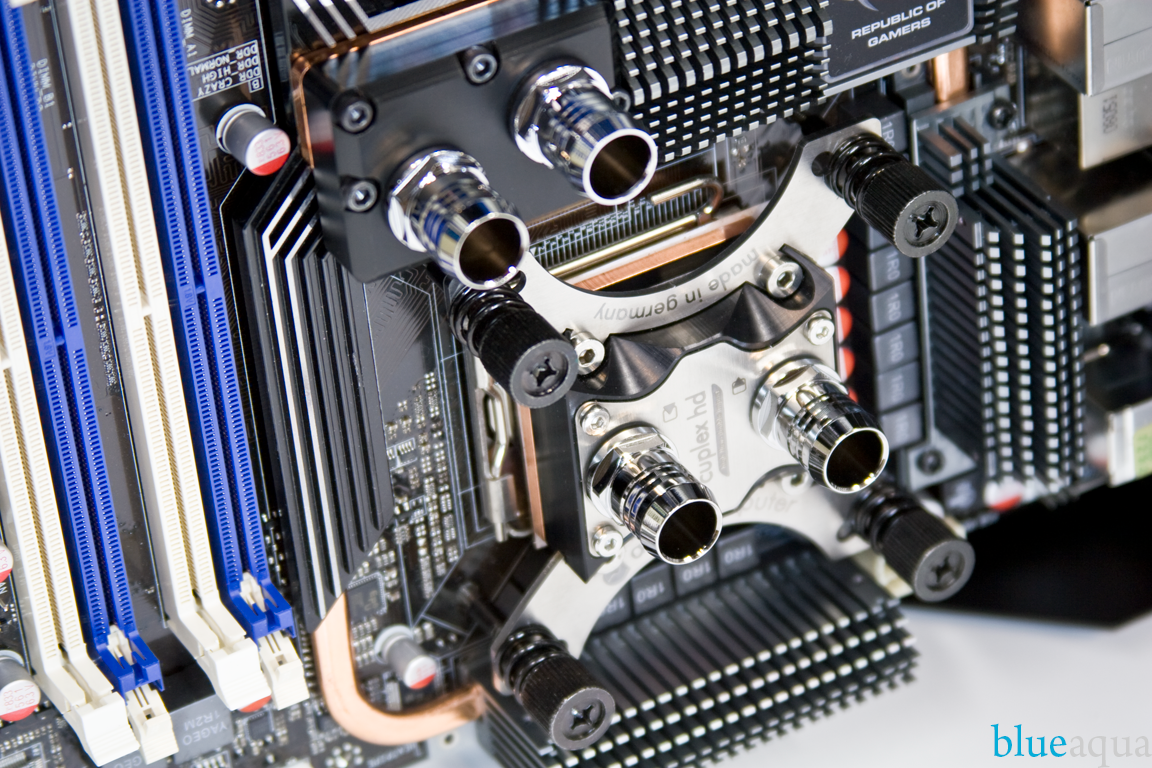

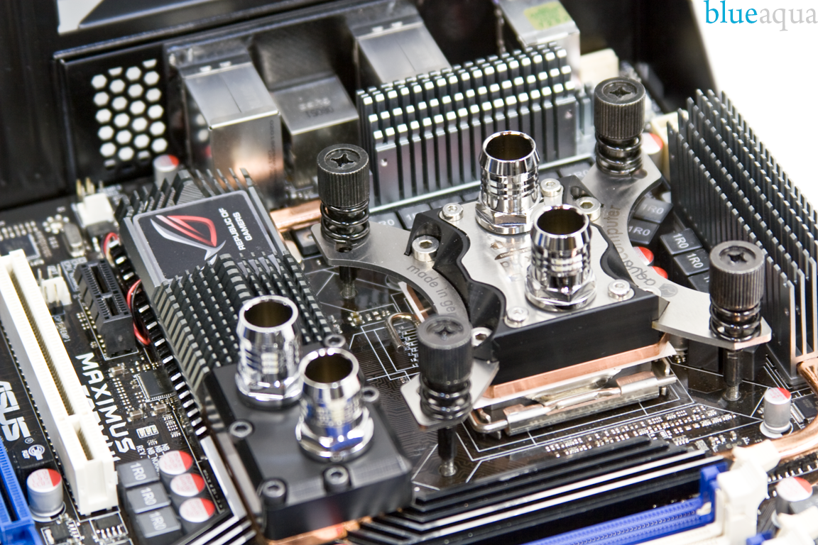

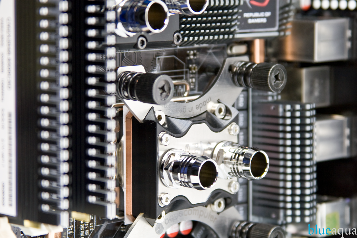

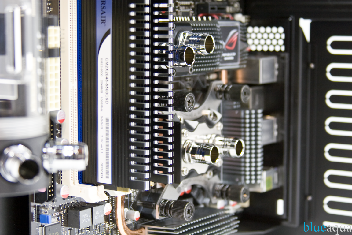

I thought I'd post a few more pictures. I'm having a little bit of Saturday fun. I hope you don't pay for bandwidth, if you do, then I'm sorry. :)
I tried playing with the sleeving a bit to get an idea on how it might look. DingDong555 gave me an idea with the sleeving. Here are some more pictures you requested.

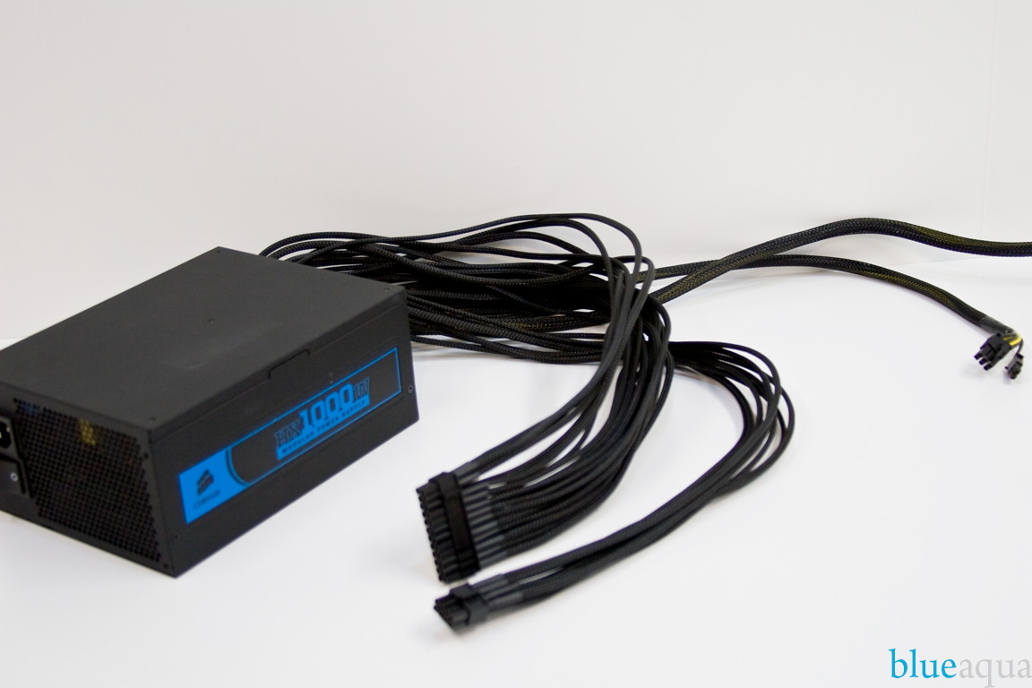

Approximately 96 feet of MDPC-X Sleeving, many hours of work, and a little bit of love I present to you the fully sleeved Corsair 1000HX. :)
http://img.photobucket.com/albums/v2...a/IMG_2595.png
http://img.photobucket.com/albums/v2...a/IMG_2599.png
A quick procedure on how I did each cable.
1. Cut 2 heatshrink lengths 20mm each.
2. Use staple in U shape, hold with pliers, put on outer edges of the pin in socket and push gently until all the way in.
3. Gently pull on wire until it pops out, sometimes this required a bit more force than I expected.
4. Slide on 1 piece of heatshrink
5. Slide the sleeving over the cable and tighten it once about 2 inches from the desired length.
6. Cut sleeving past the end of the connector.
7. Slide the rest of the sleeving into desired position.
8. Slide the heatshrink on.
9. Shink the connector side of the heatshrink so that the heatshrink is just over the first piece of metal on the connector.
10. Let cool.
11. Stretch the sleeving as tight as you can get it.
12. Shrink the opposite end heatshrink.
13. Insert new sleeved cable into connector, pops out the staple.
Repeat per cable. I hope that was detailed enough on what I did.
