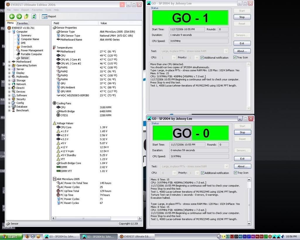

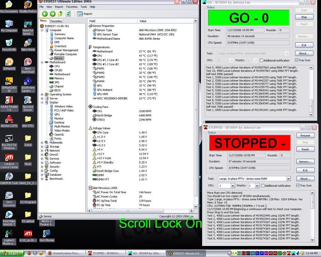

http://img90.imageshack.us/img90/5358/8hourru0.png
I decided to take hipros advice and give dual instances of sp2004 a try. I have to admit this isnt a true comparison to orthos considering im using the new bios that was updated. I have since gone from about 2hours small ffts stable to over 8hours. I also decided to loosen up my ram timings considering how aggresive they were during my last run.
I think its been shown by myself and others the AW9D-Max issues arent across the board. Some of us are doing well while others arent.
Im going to run blend next just for the hell of it.

Im actually 8 hours stable. What i said in the post is i went from 2 hours to 8 hours and i actually stopped it myself.Quote:

I wanted to post a screen of my guru temps, only thing is they are not clearly seen. 29c to 34c from top to bottom. @ Nemesis, very nice 06 score.
