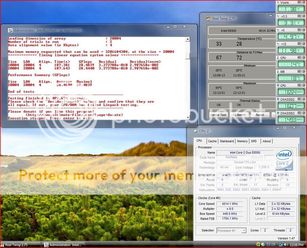

could someone please tell me how you add your images from your desktop on to your post ,ive tried using snipping tool in vista but no luck, i would appreciate any you guys could give, thanks
I use PhotoBucket.com and i upload to there. Then i insert the url link to here by using the image button.
[IMG]http://i436.photobucket.com/albums/q.../linpack40.jpg[/IMG] second try this is my first overclock attemt@4.0
