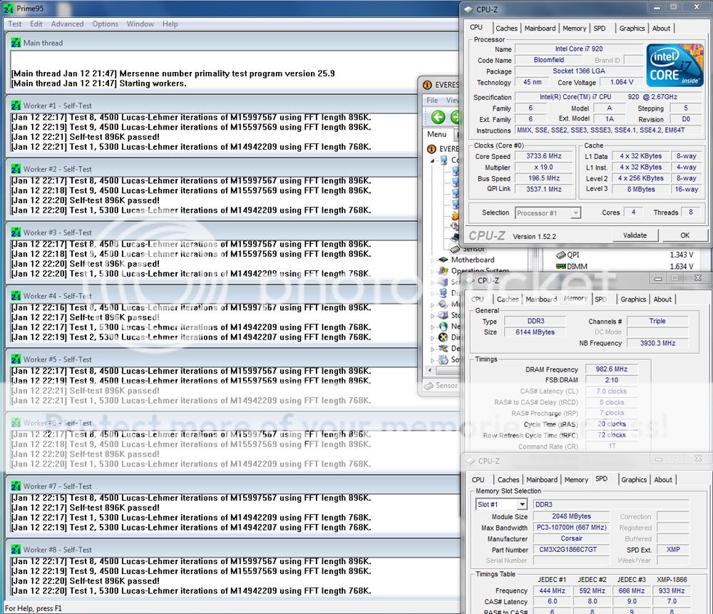

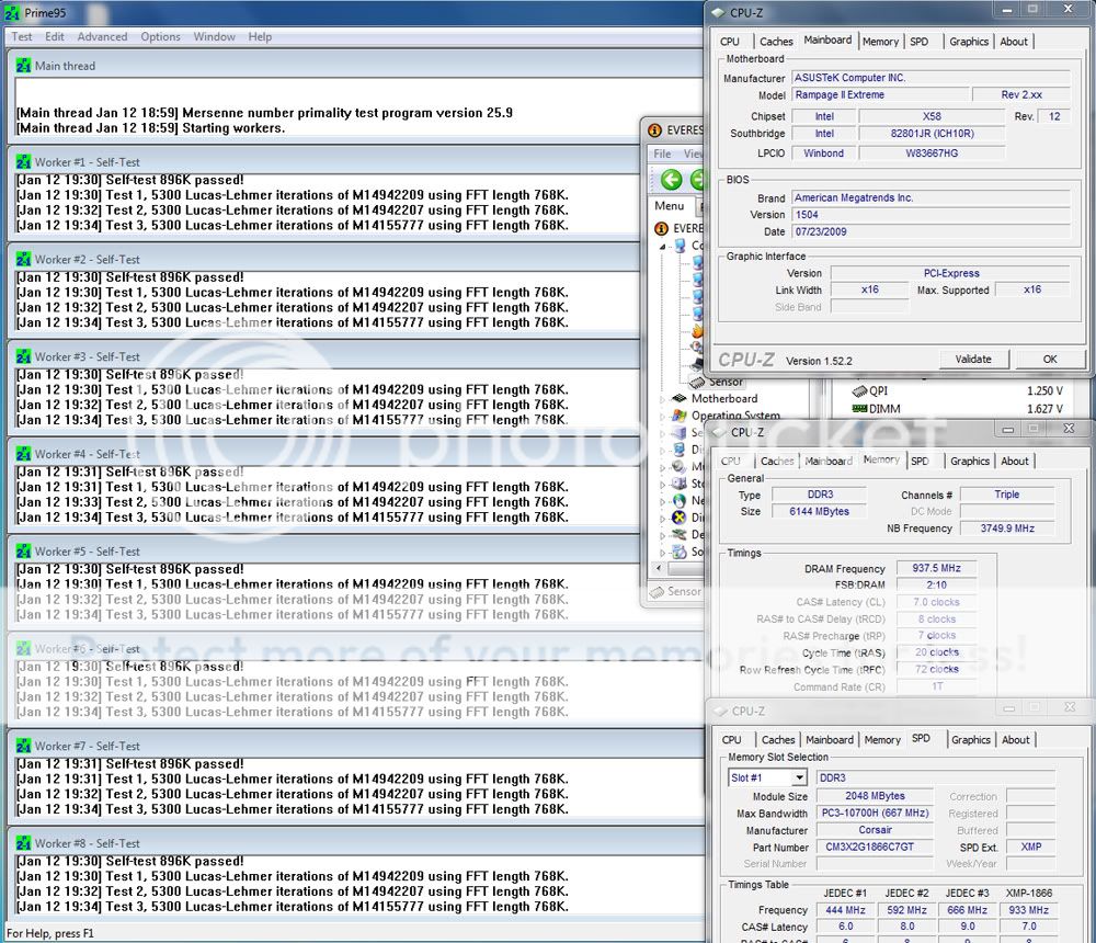

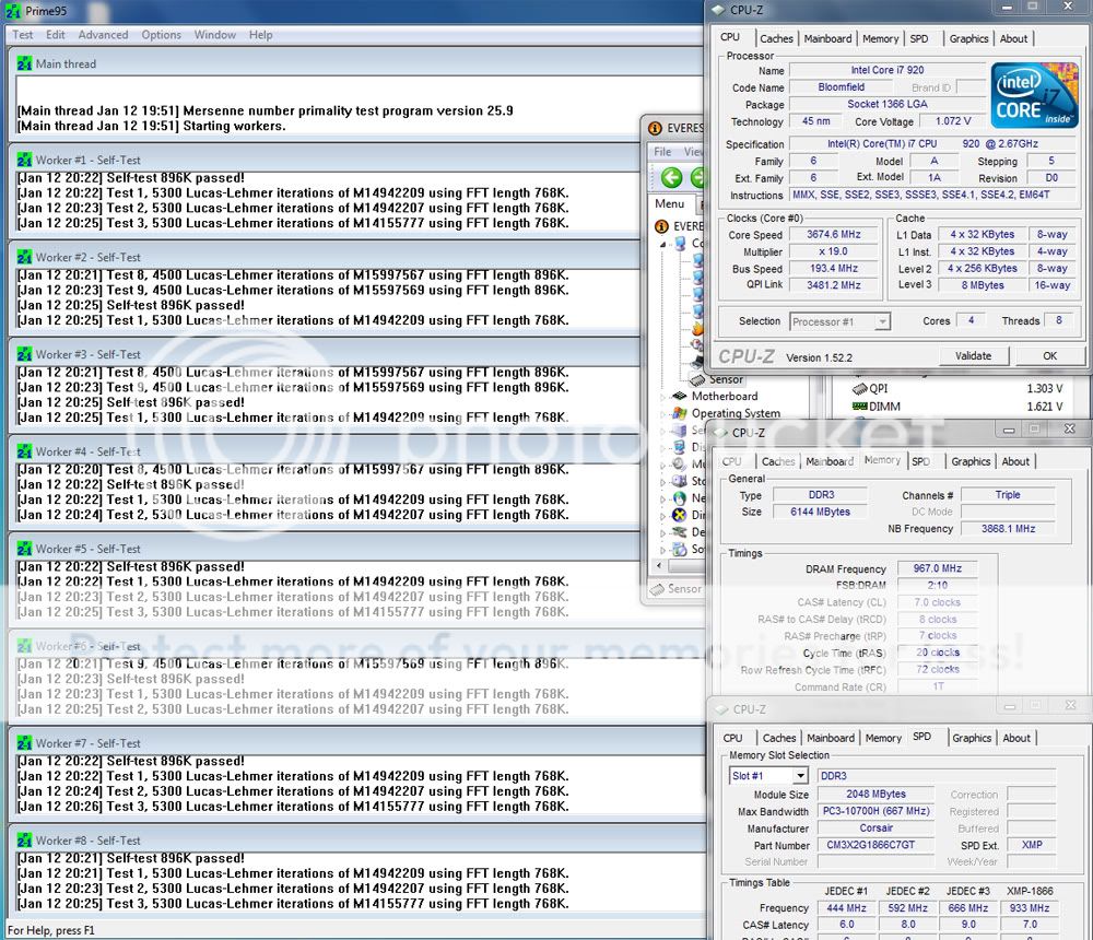

Doing a little ram testing at 'higher' frequencies to examine freqency increase of ram & uncore vs Vtt. Just ran Prime Large FFT's for ~30 mins during each test to establish basic stability.
All tests settings:
7-8-7-20 1T
Back to back delay = 4
Scaling behaviour:
DDR3-1875 MHz to DDR3-1934 MHz: +29.5 MHz on ram and +118 MHz uncore requires +0.053 Vtt.
DDR3-1934 MHz to DDR3-1965 MHz: +15.5 MHz on ram +62 MHz uncore requires +0.040 Vtt
DDR3-1875 MHz | 7-8-7-20 1T | 1.614 vdimm | 1.250 Vtt
http://i720.photobucket.com/albums/w...875MHz7-8-.jpg
DDR3-1934 MHz | 7-8-7-20 1T | 1.621 vdimm | 1.303 Vtt
http://i720.photobucket.com/albums/w...934MHz7-8-.jpg
DDR3-1965 MHz | 7-8-7-20 1T | 1.634 vdimm | 1.343 Vtt
http://i720.photobucket.com/albums/w...965MHz7-8-.jpg

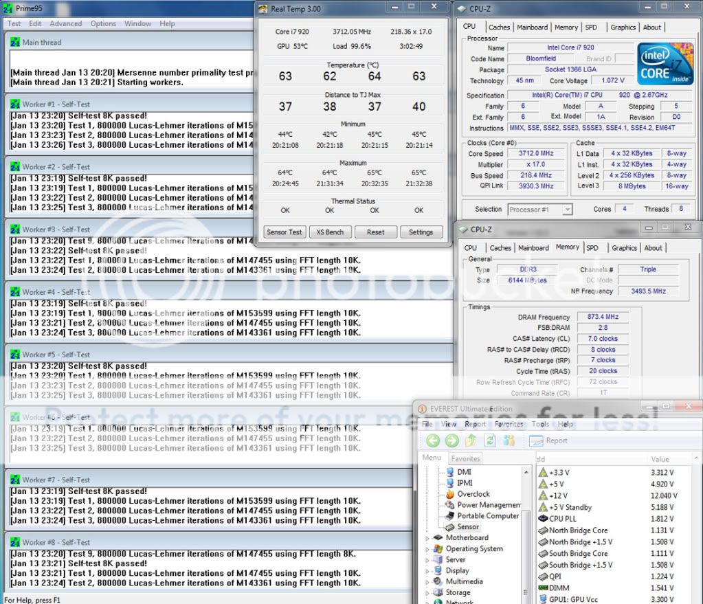

Doing some BCLK testing.
3 Hours Prime95 - 218.4 BCLK @ 1.072v | 1.224 Vtt | 1.131 vNB
http://i720.photobucket.com/albums/w...7107v-1131.jpg
First I thougt I got a bad Overclocker as I hit a Bclk Wall @ 214 (Boot with 212, TurboV or Setfsb to 214).
Benchstable I got 212 bclk with 21 Multi on my W3520.
