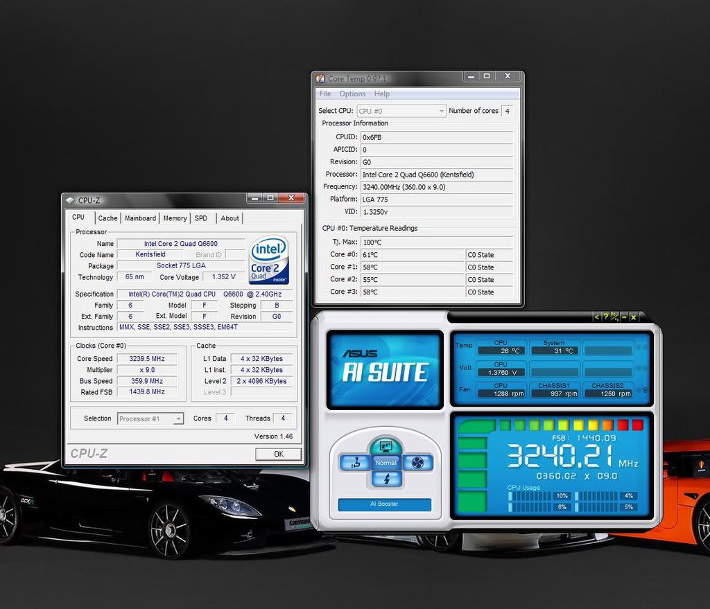

Here's a clip from last night.

It all comes down to scaling... 3.4 will probably need 1.4v+
I was just going to post that ... yeah it may need 1.40-1.42v to get 3.4ghz on that VID ... another issue will be cooling as at 1.40-1.42v the temps will rise to at least 65C-70C full load on his cooling, priming in the first hour to get MAX temps.
So maybe MAX on his rig will be 3.2-3.4ghz with his cooling setup, but more likely 3.2ghz cause of cooling issues maybe all that will be 24/7 on his rig, but you never know... good air cooling is a must when hitting 1.42-1.43v on the Q6600's.
I am priming for 3 hours. I know, it may not enough for many , but it is ok for me as in real life i am not using my comp for anything heavy, except for gaming which still do not stress cpu as much. So my benchmark is to be 3h prime stable. ;)
Anyway, I went for 3.4 and core 3 failed within a minute. raised voltage to 1.35 and it failed after 3 minutes. :( so, no 3.6 for me i guess. will try to raise voltages more but, i do not want to go over 70°c. is there anything else beside cpu voltage that i should raise?
I am still new to 755 platform so excuse me if asking stupid questions.
edit: I set it for 1.360v and now it says 1.352 in cpu-z/ai probe and it is been stable for 30mins, temps are 66/66/59/59
Update: It seems prime stable at 1.36 (cpu-z/ai probe) at 3.4ghz which I guess is not to shabby for 1.325 VID chip. :) Temps are 69/69/62/62 (core temp).
Are those ok for 24/7 use?
There's nothing wrong with 1.325VID chips. Mine made it to 3.6 at 1.4V, just the same as my 1.2625VID chip. It would not, however, scale to 3.8GHz, and would not give me the nice 3.0GHz at 1.176v like the 1.2625 would. The scaling at the mid level frequencies was good, the at near the end points it was not as good a chip.
