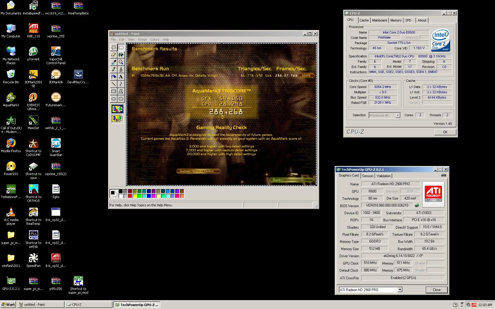

http://i48.photobucket.com/albums/f2.../aquamark3.jpg
5ghz benchies started!
GG :p: keep pushing ZenEffect :up:
