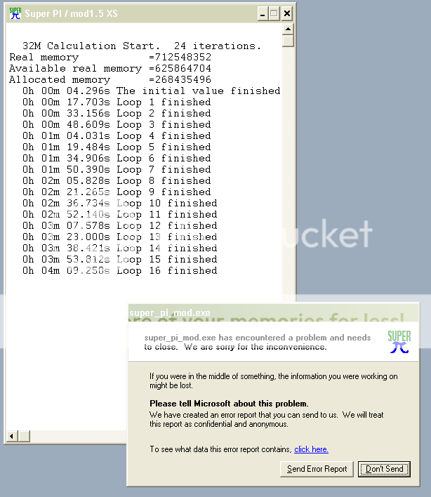

i've wasted loads of time trying to stop these program errors but finally seems ok after i raised vcore 0.09V.
been quite hot weather here and i've seen this message a lot.
http://i447.photobucket.com/albums/q...og_error_1.png

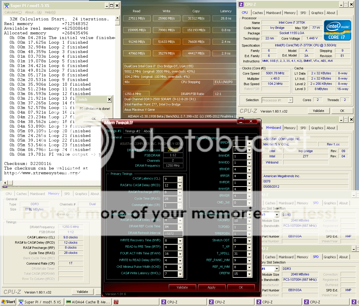

cheapseats - 6:19:781 - 48x104.2 - 1250.5MHz - 9-12-8-28-84-1 - ASUS MVG - Exceleram EB3103A 4x2GB/PSC - 1.80V - air
4x2GB
http://i447.photobucket.com/albums/q...078_EX_8GB.png
^ Nice run :up:
Why the 4x2GB? And very effecient run indeed....
