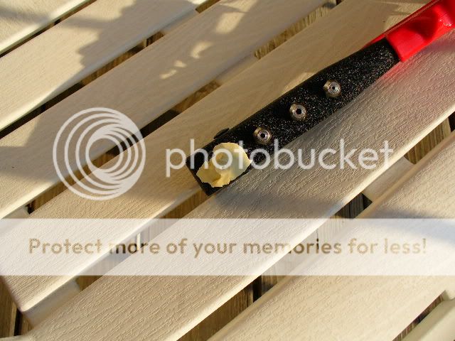

This next part, I don't like. The EK instructions say the standoffs are "obligatory" or something like that. Yechhh - I will pay extra for standoffs made as part of the block. This is cheesy. Used some MX-2 to try to hold the plastic standoffs.
http://shazza53.smugmug.com/Computer...22_MgQCT-M.jpg
