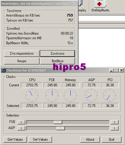

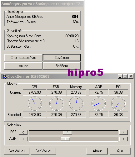

Here's a comparison for the P4P800 and the P4C800 mobos......
P4P800-SE
Take a good look at the ram speed here......
http://www.thelab.gr/images/Hipro5/D...aR_694_png.png
P4C800E-Deluxe
.....now take a good look at the ram speed here.......
http://www.thelab.gr/images/Hipro5/D...aR_759_png.png
As you can see here, the ram on P4P is on a LOT higher frequency than the P4C one.......BUT PAT works fine on the P4C......The "phseudo PAT" on P4P isn't doing a good job....... ;)

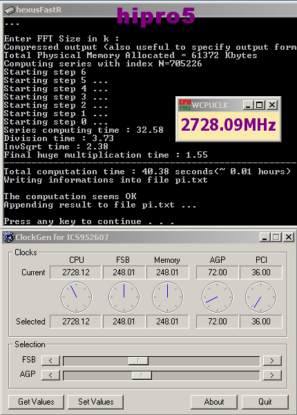

All test are with everything aggressive
AGAIN P4P800
http://www.thelab.gr/images/Hipro5/D..._41.54_png.png
.......and P4C800.......
http://www.thelab.gr/images/Hipro5/D..._40.38_png.png
P4P800
http://www.thelab.gr/images/Hipro5/D..._32.99_png.png
P4C800
http://www.thelab.gr/images/Hipro5/D..._31.72_png.png
As you can see there is no comparison between those two mobos......P4C800E-D is way ahead of the P4P800-SE.......

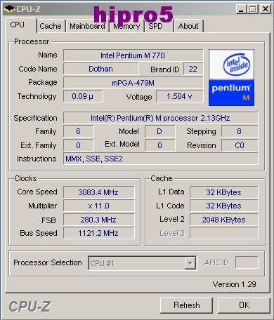

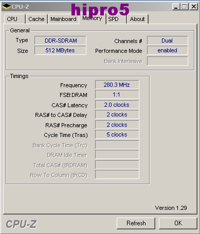

.....and max RAM frequency on P4C800E-Deluxe.......cpu-z verified......a bit lower...not 280MHz but 279.8MHz..... :D
http://www.thelab.gr/images/Hipro5/D...sb_1_1_png.png
http://www.thelab.gr/images/Hipro5/D...0_cpuz_png.png
http://www.thelab.gr/images/Hipro5/D...700_id_png.png

Booting at 201MHz is a NO GO....... ;)Quote:
Originally Posted by Bisteccone
You HAVE to boot at 200MHz so as to see some real gain........ :)
http://www.thelab.gr/images/Hipro5/D...-Pi_25_png.png
True, but it's really heavy on the board!Quote:
Originally Posted by hipro5
boot @ 201 we can reach ~265 Full PAT
boot @ 200 max is ~240, but the numbers are better for sure!
It's not "full PAT".......It's some kind of "phseudo PAT".........You loose a LOT by booting at 201MHz.......Almost 1sec in Super-Pi....... ;)
ALSO Rams at 270MHz by booting at 201MHz, do worse than 240MHz by booting at 200MHz......
