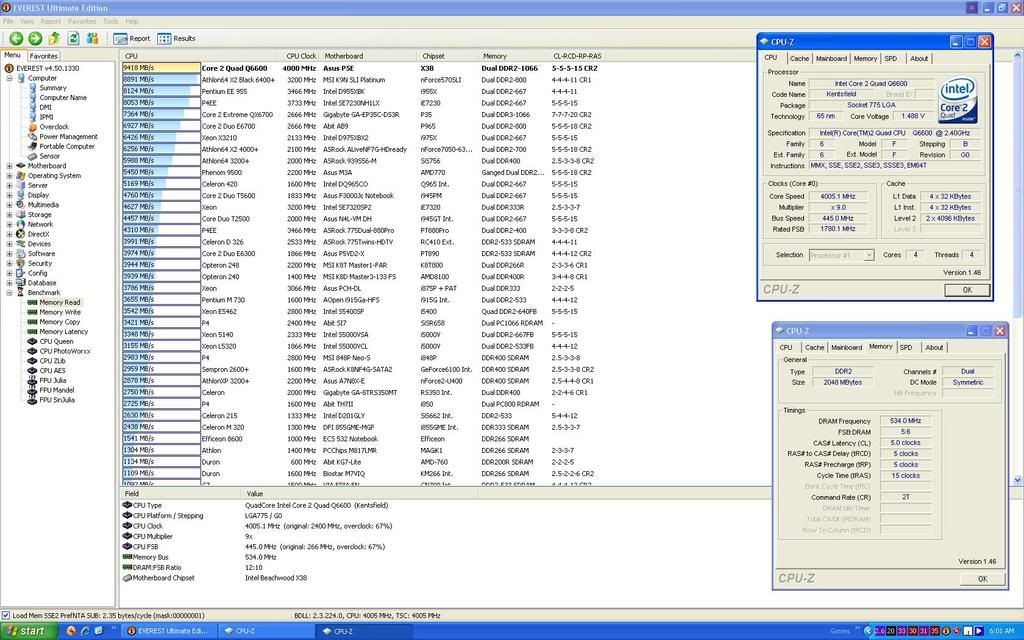

Thx, I hope u can finally get a good one. I got it to 4.0GHz this morning :D
http://i292.photobucket.com/albums/m...1MRecord-3.jpg
http://i292.photobucket.com/albums/m...stCPUQueen.jpg
http://i292.photobucket.com/albums/m...MemoryRead.jpg
It was meant to be like 5C room temp, but it was only 10C to 13C.
