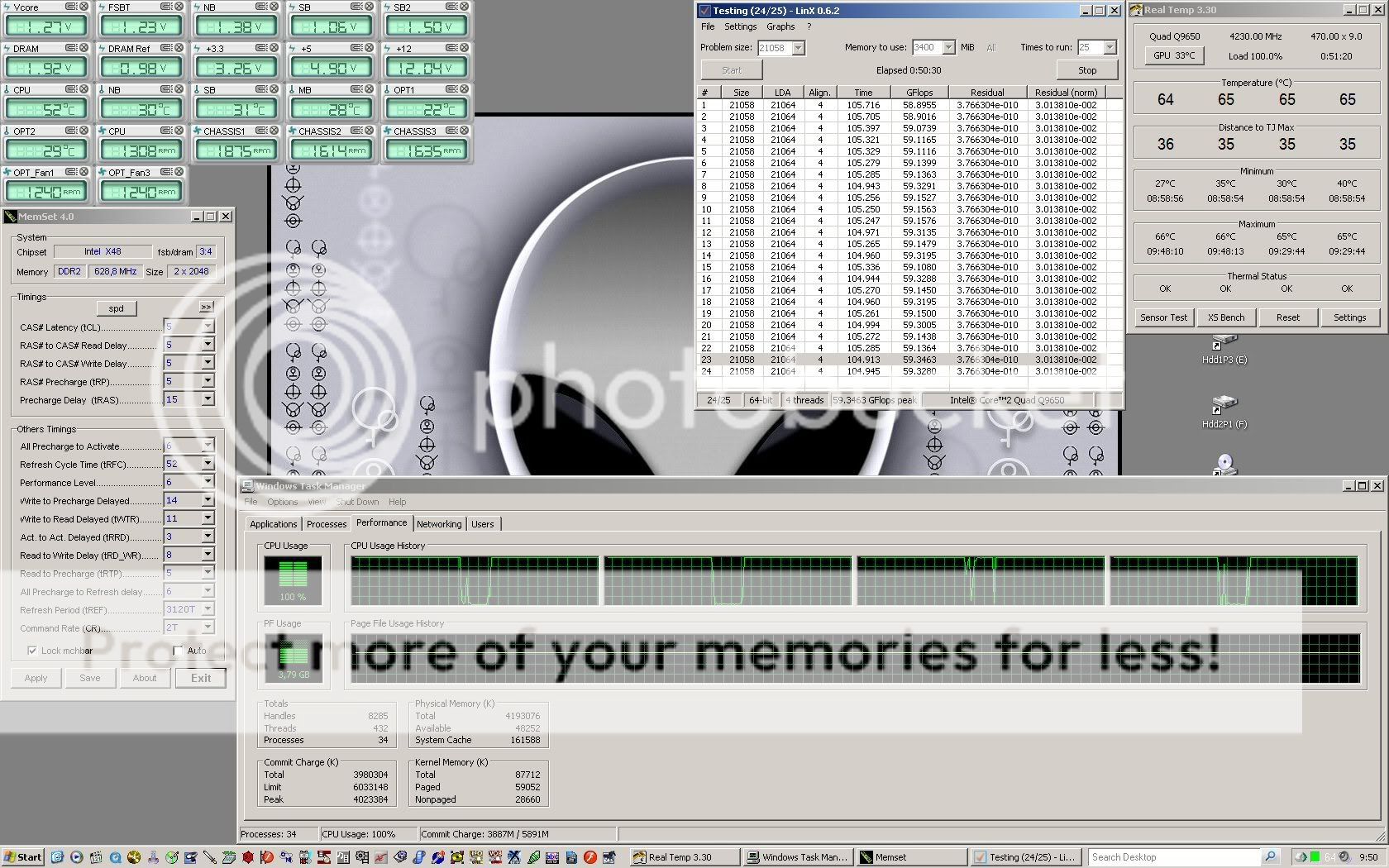

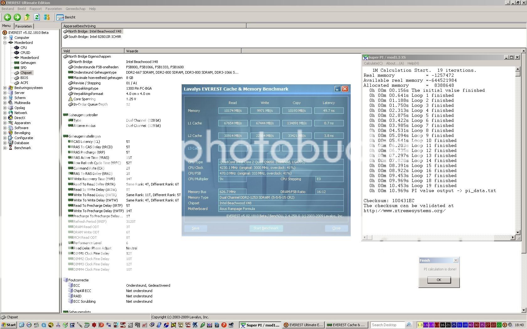

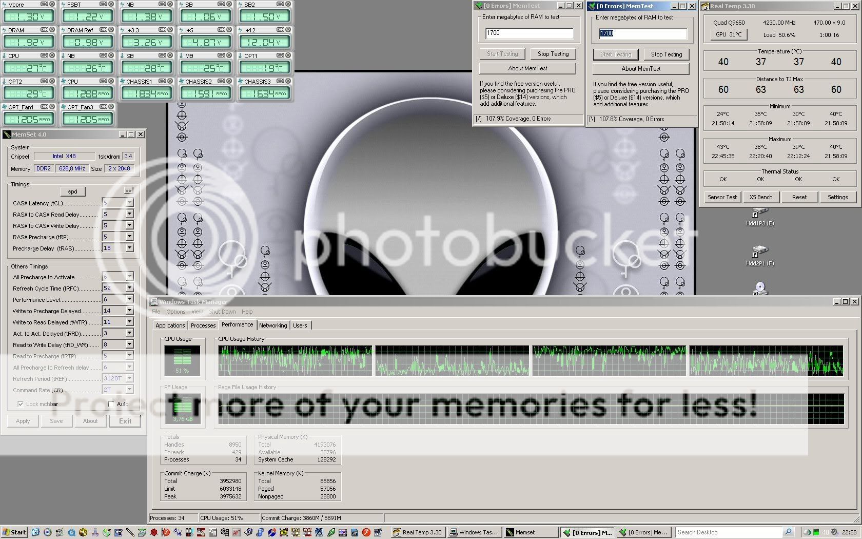

My new 24/7 overclock. :)
Q9650@4.23GHz - DDR 1253MHz - tRD 6
http://i431.photobucket.com/albums/q...D6-MemTest.jpg
http://i431.photobucket.com/albums/q...D6-LinX-BI.jpg
http://i431.photobucket.com/albums/q...D6-EVEREST.jpg

I have to test it for a longer period with Prime95 Blend. I did a 1.5 hour run yesterday without problems but I want it to see Prime95 Blend stable for 6 hours or more.
As you can see Ai Clock Twister at Light makes it possible to have a stable overclock above FSB 450MHz with reasonable NB Voltage and FSB Termination Voltage.
This isn't possible with any of the previous BIOSes. Changing Ai Clock Twister to Light didn't make any difference in stability because the problem was situated in the memory configuration in the BIOSes.
I was lucky that I could do 10-15 MHz above FSB 450MHz with Ai Clock Twister at Moderate. I guess that my NB clocks a little better than average.
