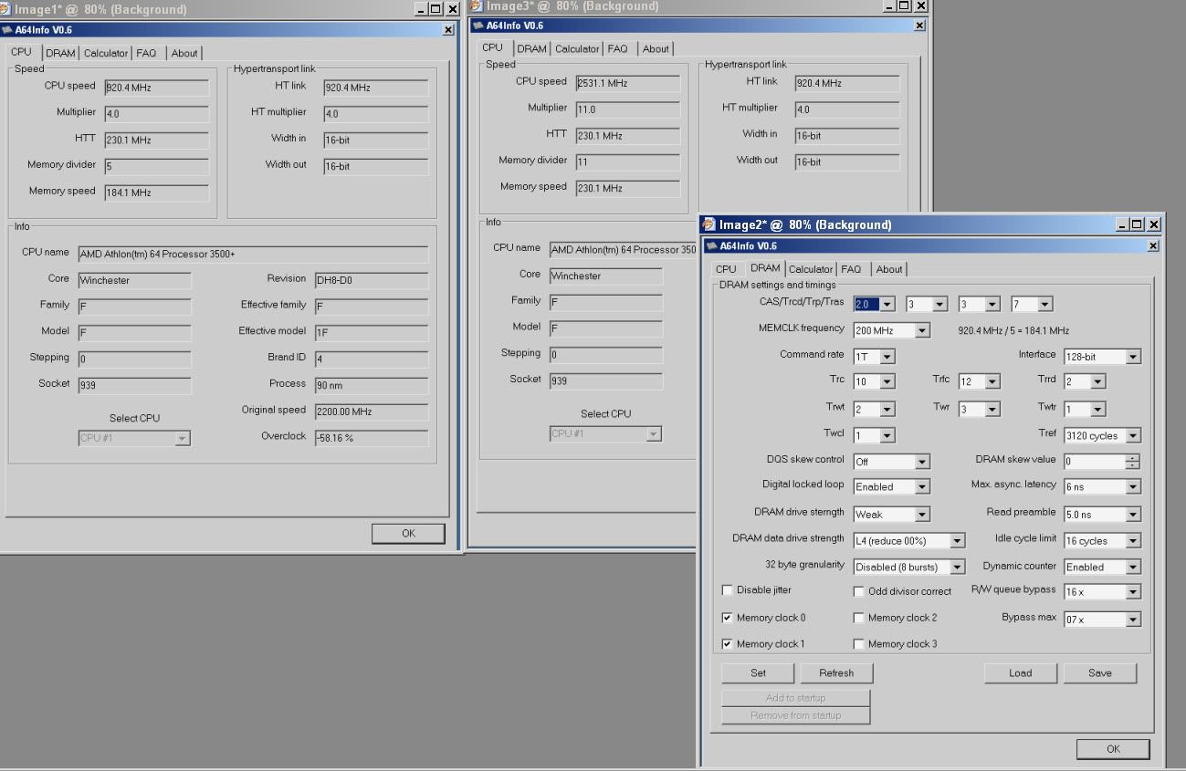

I spent the last few days again digging in the depths of A64 dram control registers..and this helped me a lot.
Although...i think i found a bug (or a misunderstanding).
When i clock down the multi (with rmclock, Cool'n'Quiet etc.), say my default is 11x and i clock down to 4xHTT...then A64info says that i have a mem-divider on and also says my memory speed is down to 183.
I do not have a mem-divider on (running 1:1) and my memspeed is the same as HTT, 230mhz. I double/triple checked with many other tools.
eg. clockgen says right my MULTI is down to 4x, but HTT stays and also reports my memspeed still as 230.
Also..it is not known to me that rmclock (or CnQ) would switch on a divider and reduce memspeed.

Smallest possible memory divider is 5, According to Oskar Wu. So, your CPU is running at 4 x 230 = 920MHz. Memclk is 200MHz, and memory divider should be 4, but 4 is less than 5, so divider is 5. Memory speed is 920 / 5 = 184 MHz. Of course , this is theory. A64Info is calculating memory speed with respect to HTT, Multi, Memclk, ODC using known rules. It would be nice if A64 had some register which contains actual divider, but AFAIK there isn't one.

What i want to say is....i SHOULD still have my original "divider" which i have in bios...1:1, MEMCLK=200, HTT=230
When i use rightmark rmclock it can set multi to anything from 4x to 11x depending on load under XP, clocking the CPU up or down...but i dont THINK it would activate a divider. But A64info says i have a divider set (which i did not) and also the "real" memspeed should still be 230. (memclk=200 in bios, ok ;) I think that you with A64info read the multi and calculate and show the theoretical calculated divider/memspeed...but in reality its just not set.

Please send me a screenshot of CPU and DRAM tab. I tried on my rig 4x multi and memclk=200, A64Info reported memory divider as 5 , also CPU-Z reported the same.Quote:

Look at your picture again. Divider (memclk) is not set at 183, that is why I asked you to send me a picture of memory settings. Memclk is set at 200, but it doesnt mean thar memory divider equals cpu multiplier! Try to use half multi for example 10.5 and see what happens. Also, choose odd CPU multi (11) and set Odd divisor correct and see what happens.
Bottom line: memlck = 200 doesn't mean always 1:1 ratio. Use builtin calculator and experiment with ODC and half multis.
