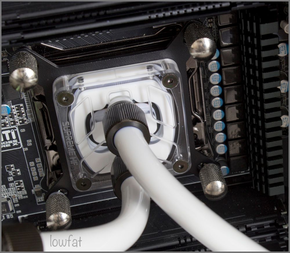

Bill Owen introduced me to Ice Dragon fluid at CES. I gotta say, I was really impressed. I'm an anti-foam warrior which is hard to battle when running a lot of head pressure but this stuff behaves excellent in that type of situation.
An amusing anecdote...I was sitting there talking and asking questions and all the while I thought they were using white tubing, like beautiful white Primochil tubing. Turns out the fluid really is a brilliant white. And when I say white I mean solid white--not milky white.

Ya you really can't tell that it isn't clear tubing. Even right up close it looks completely solid.
For those curious about tubing, I am currently using Primoflex clear. It still looks perfectly white, and it has been about three weeks so far. No idea if it is clouding or not, but I sure can't tell the difference.

I'm a little over a month into my loop. I'm using the Primoflex PRO LRT Clear and it has no clouding.
The front of my Aquacomputer reservoir has no clouding either.
I love this stuff, it's like android blood.
I had mine running about 4-5 weeks and just drained it last night. The 3/8ID 5/8OD Primoflex I just turned brown. Fortunately that tubing is all on the backside of my motherboard tray. The 3/8ID 1/2OD stuff did not turn colour, but it did cloud up. Wasn't noticeable while it was filled though. I was able to brush clean the 3/8ID 1/2OD though. So now it looks brand new. Didn't try cleaning the brown tubing as I didn't notice it until I already started to fill the loop again.
As for the nickel blocks. No corrosion, but I had to take the GPU block apart to give it a good cleaning. It took a serious amount of elbow grease to get clean. Not sure what was the cause of this.
Still using the same coolant though.
Lowfat - let me know if your tube turns brown again. We have seen this before and have narrowed it down to plastacizers in the tube. We have ONLY seen this happen in tubes that are strictly VINYL.. we haven't seen in it in tubes that are PVC. We don't know if the poly vinyl makes a difference or not. Also, it only happens when exposed to UV lights. We've seen it in the sun. We do know that it doesn't affect the fluid or make the fluid brown. Also, I am not sure if the reaction with the plastacizer will be a finite reaction; meaning that once you run the fluid thru and it reacts with the plastacizer that all the plastacizer will be used up and then you can clean and re-use without any problems. But, we haven't done that. So, let me know if you get a chance.
