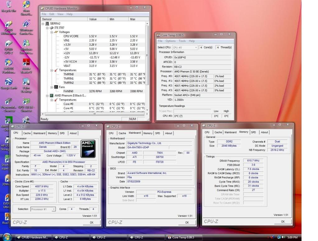

Flashed to f6a this morning. This is my best overclock yet.
3760 (235x16)
8gb ddr2 800 at 940 6-6-6-18
HT link and NB both at 2500
Ram did indeed go higher on f6a than f5.
I still can't get to 4.0 though...

I just did a quick testing with the MA790XT-UD4P:
http://img40.imageshack.us/img40/7393/3900.th.gif
This 925 is awful (no SuperPI @ 4GHz even with 1.6v), but the board looks very nice.
Later I'll try a X3 720 Black :)

GMA 790X- UD4P ....EPP now works @1066 and Higher with out reboot Bios F6A has fixed the AUto Ram AutoEPP detect setting ....
Before when you would try and Run on the 1066 divider with Auto EPP..It would Shut down or Lock up PC.
Now setting the the Ram speed to Auto instead of 533/800/667/266/200 you can use (Auto) to detect Your EPP settings for DDR2 1066mhz and higher ram .
You are no longer stuck with 5-7-7-20 timing and buggy ram @default timing Of the MOBO if you were running 1066 that has EPP setting.
You can now set the EPP Auto timing which applies to your Ram Cas /trp and mid timings... It is even stable past 1150mhz now..

Tested with Patriot Viper 9600 2x1gig ,, Ram is good for 1255mhz @ 2.3v
F5 Bios was Only faster here because my NB is @2800mhzMG]
Using 800 ram divider @1150 ,, about the Most i could use above 4100mhz no matter what NB freqency or CPU multi i used. Since timing and Stability was a problem using 1066 divider i had to use the 800 divider .
http://i168.photobucket.com/albums/u...4104mhzNB2.jpg
NOW im able to use the 1066divider with EPP
Auto EPP (auto timing) and 533 to get this timing as my default with 1066 divider and while using any NB/Cpu multi combo,,
Good work Gigabyte cant wait for the Official Bios :up:
http://i168.photobucket.com/albums/u...PP_F6Abeta.jpg
