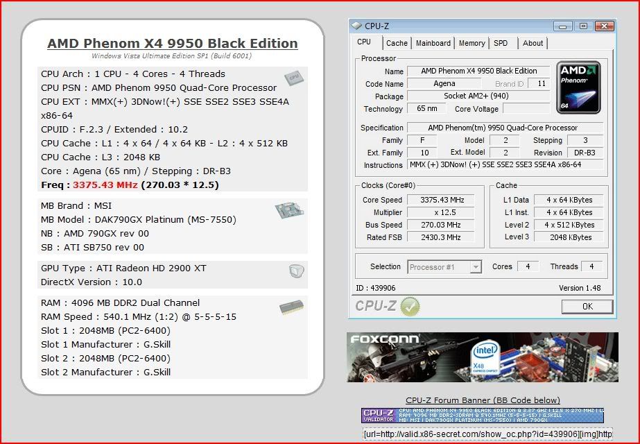

NB and HT frequency was good up to 2520mhz at the max volts in the bios, fsb is good to 279mhz, memory is good to 1100mhz, cpu went to 3600@1.6v.
So I tried to get the most from every part of the system to get as close to max stable settings in each sector seems like this is it unless I either get better cooling to run 1.55+v 24/7 into the cpu because the next step up is 3.51ghz and I need 1.55v to run at that speed, Im going to try benching at 3.5 tonight but Im pretty happy with this setup now the way it is.
Im also going to try lowering the voltages little by little. Since I know this is stable I can lower each one at a time test for a day and if its good just leave it.

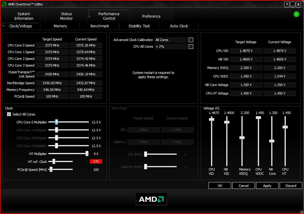

http://i271.photobucket.com/albums/j...th_3375mhz.jpg
http://i271.photobucket.com/albums/j...th_memory1.jpg
http://i271.photobucket.com/albums/j...71/th_aod1.jpg

AOD seems to be a bit crappy on my setup (also with my previous 9850BE). I tried both 212 as it's the newest version available from DFI but also 214. It might be that I need to get another BIOS though, but I want to be sure since Im not going to flash for every fart like I did with the 790FX-M2R:p:
Anyway, the problem is that, apart from the GUI which is a bit confusing, I cant seem to get ACC working via AOD. It stays greyed out:confused:. What I mean with the GUI is that whenever you click a setting, which normally would result in a little 'V' as selection, it just doesnt happen. You cant see whether you activated something or not. I hope you guys understand what I mean:p:
Also, I cant seem to get my HTT very high. I didnt try to find the max, but 250Mhz was bootable but would BSOD fairly quick, same for 240Mhz. It's been so long I tried to get the HTT higher on my previous build, which never worked anyway, I might have forgotten some easy solutions to get it higher.
So does VNorthbridge, VSouthbridge, VHT, Vcore or whatever help in this? Or any settings? To be sure I lowered even my RAM multiplier and of course HT and NB multiplier. But it didnt help.
set the ht and nb multi to 10 for 240mhz fsb and 9 when going over 250 this will give you just the right play to go higher or lower between 2400 and 2550mhz. I raised my nb and HT volts to 1.4-1.45v just for the hell of it to get it stable These voltages will not harm the system if you have a cool running system if your system runs hot with minimal fans I wouldnt go far with voltages.
It took 1.5v to get to 2520 mhz though on the ht and nb which was too high so I just run between 2400-2500 in that vicinity.
Oh also turn on acc in the bios and set it to +2. If its disabled in the bios I think it stays grayed out in AOD but even if you try and set it in AOD it still makes you reboot so I just set it in the bios and left it like that.
Wow I opened up AMD overdrive. Set my vcore to 1.395, Set NB-vid to 1.370 and the multi to x16 to get 3.2ghz and its 2 hours prime stable. Im amazed it was THAT ez. Oh and I had to put ACC up +4. And my temps are 50*C load and 29* Idle.
