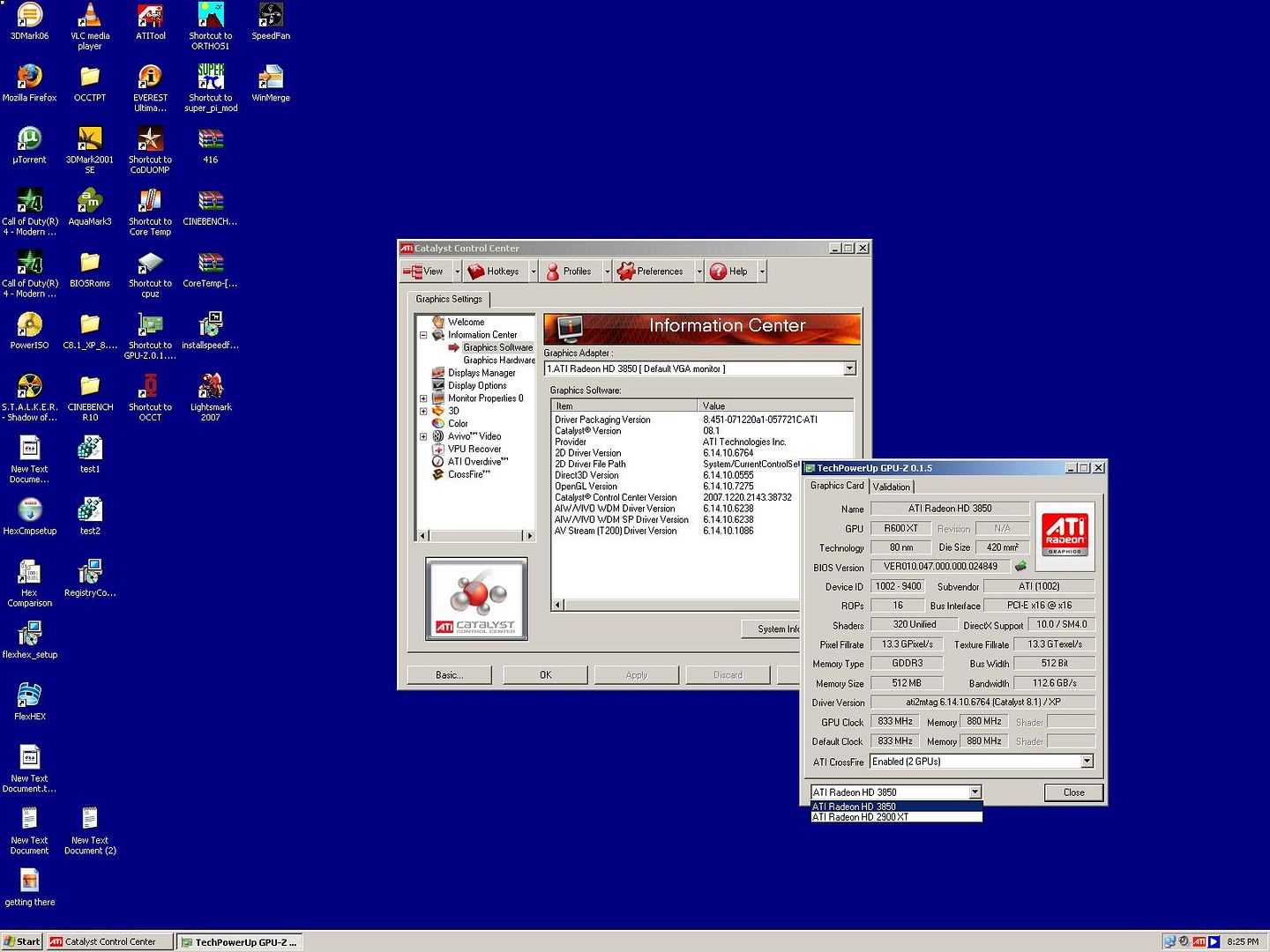

getting there :up:
http://i48.photobucket.com/albums/f2...976/hahaaa.jpg
getting there :up:
forcing 3850 or 3870 doesnt work :down:

Little cryptic but I tried it, and guess what its working now :D thQ m8
here a pic of what my ccc now looke like.. damn shame I cant change my 3d clocks but then again ccc only goes to 858mhz something so its all good :P
And the windowed mode problem still isnt fixed by ati.. And im not fund of setting 3d speeds in 2dmode all the freaking time.. But from what ive heard new version of Rabit is nearly completion 80%.. still no beta but its getting there
http://www.acidcool.nl/catalyst82works.jpg
