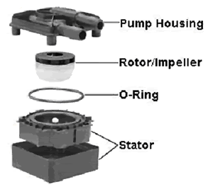

Is the o-ring in there?
Looks like a PTS head that's not tight enough or has it's o-ring left in the stock top.

This shows the o-ring I mentioned.
http://img.photobucket.com/albums/v4...pinternals.gif
It sits between stator and top. Can stick to the top and be missed during re-assembly with a new top.
Indeed it was there, thanks a million -- disassembling now.
