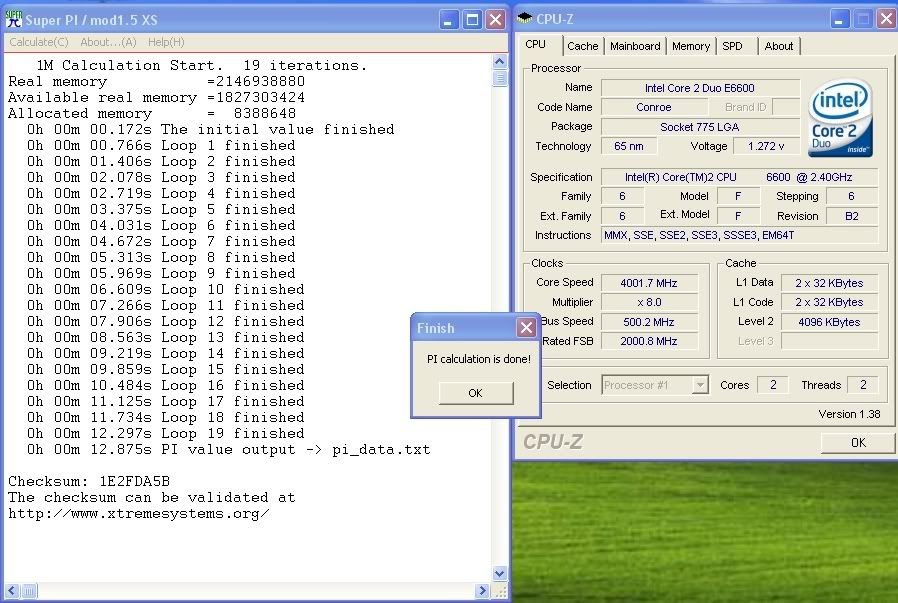

Ok this board was a PITA to work with. For some reason I had problems installing vista/xp with raid. I had to settle for single drive for now. Also it seems there is some kind of a fsb hole because I couldnt pass 430+ but I can boot with this.
http://i55.photobucket.com/albums/g1...24/in9_500.jpg
Any other bios out yet for this?

This board is weird, sometimes the settings will load right and other times it wont. Maybe it has something to do with the boot strap not sticking. The PWM also gets really hot on this thing. about 60-67C at these settings. Also my ram is acting strange on this board, seems not to like anything less than cas5. Here's my setting for 500fsb. I had to boot 480fsb then clockgen up to 500. Also for the usb keyboard/mouse problem, you need to set it to bios instead of OS in bios.
http://i55.photobucket.com/albums/g1...Picture003.jpg
http://i55.photobucket.com/albums/g1...Picture004.jpg
http://i55.photobucket.com/albums/g1...Picture005.jpg
http://i55.photobucket.com/albums/g1...Picture010.jpg
http://i55.photobucket.com/albums/g1.../in9_500_1.jpg
http://valid.x86-secret.com/show_oc?id=161792
Thanks
