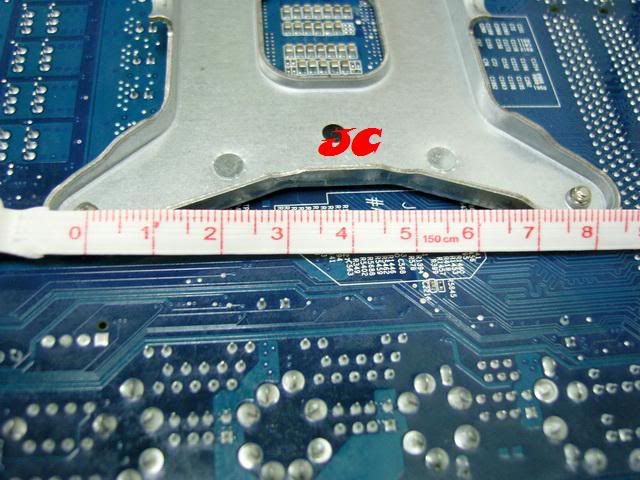

The cpu cooler mounting dimensions :D?
Sorry for this rough dimensions(cm) :ROTF:
Gainestown & Bloomfield is the same dimensions ... ;)
Gainestown :
http://i245.photobucket.com/albums/g...laneous/D1.jpg
http://i245.photobucket.com/albums/g...laneous/D2.jpg
http://i245.photobucket.com/albums/g...laneous/D3.jpg
Bloomfield :
http://i245.photobucket.com/albums/g...laneous/D4.jpg
