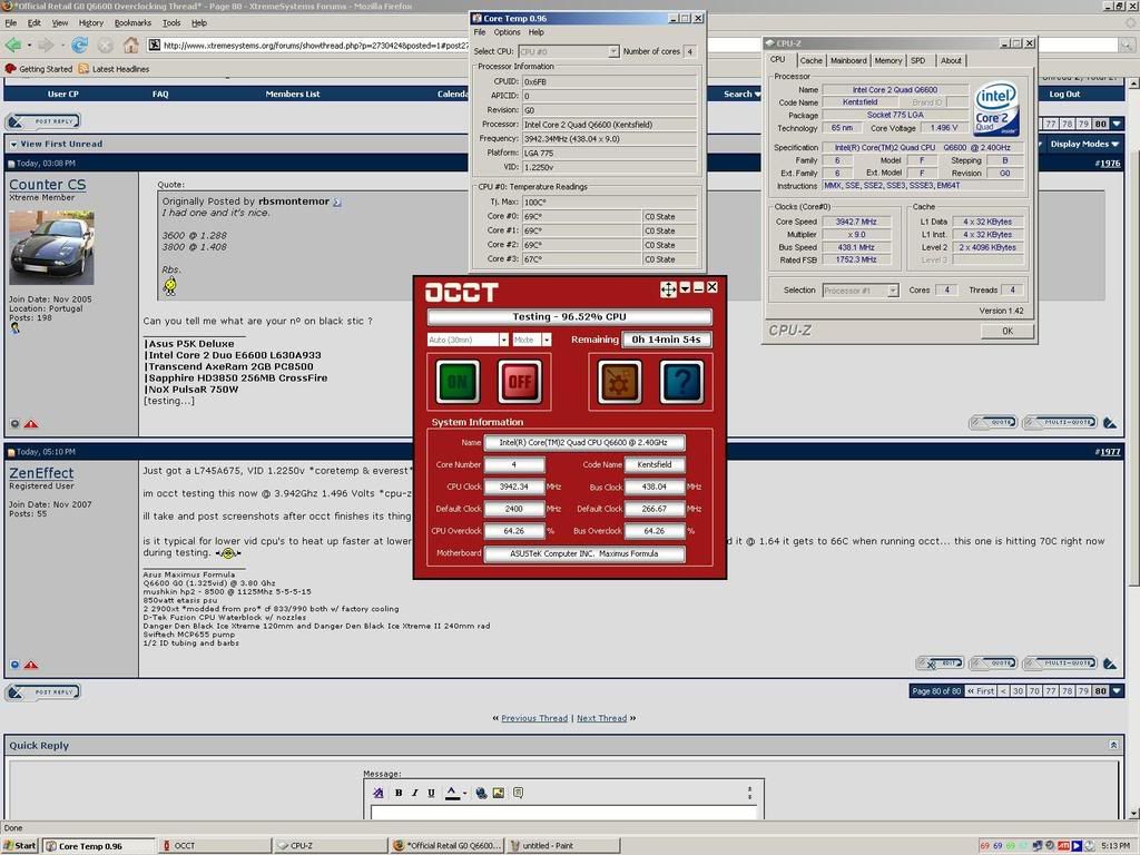

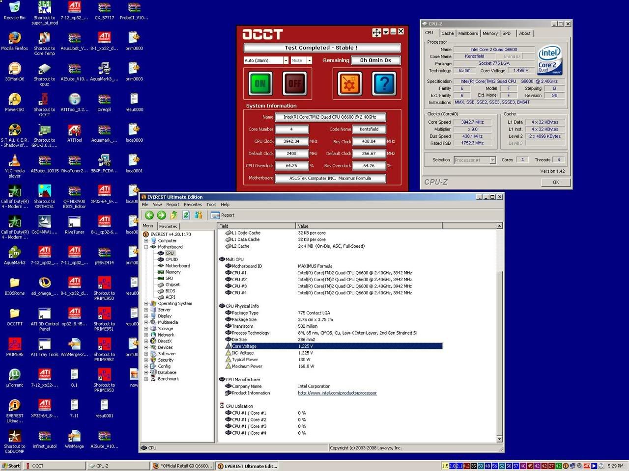

hallo mate can you explane me this?..
.i used same everest..shows 11C...
core temp 0.96.1 showing core 0 12C core 2 16 ....
when i running 3dmark06 core 0 shows... 17C and core 2... 16C
look
http://img85.imageshack.us/my.php?image=ddddui7.jpg
look

Here we go, stable for over 4 hours in Everest stability.
http://aycu06.webshots.com/image/443...4585016_rs.jpg

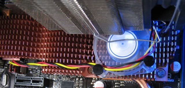

One question: are u guys with that low NB temps using the little fan that is in the package that anandtec recommends for cooling the NB? That would (maybe) explain your ultralow temps of 45 C or even less.

I'm using a quiet 5CFM 40mm from the Jing Ting NB Cooler. Dropped temps 7C.

Currently running at 3.7GHz, was wondering if I could get 3.8GHz or even the coveted 4.0GHz? :D
My Maximus is on water, and kept in a cold 61F(Today) Ohio basement.
This is a screen shot I just took minutes ago, using the BIOS settings listed below.
My temps are currently reflecting just over 1 hour of hard labor running Prime95: :up:
http://img142.imageshack.us/img142/4693/run7wz7.jpg
These are my current best BIOS 907 settings: Always looking for advice. ;)

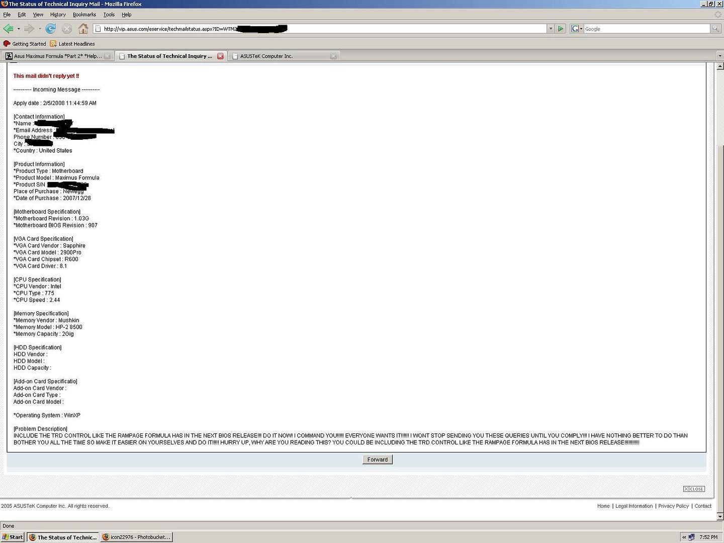

Time to start applying some pressure on those bios engineers through tech support:
ASUSTeK COMPUTER INC. (Taiwan)
Technical Support
Hotline: +886-2-2894-3447 (0800-093-456)
Email: http://vip.asus.com/eservice/techserv.aspx
Knock yourselves out.

This makes my memory run at 848MHz, and gives me a Core speed of 3816.3MHz.
Not by much, but still enouigh to officially get me into the 3.8GHz club! :woot:
Prime doing it's thing crossing the hour mark error free. Still looking :cool: too.
http://img112.imageshack.us/img112/5362/run8ql4.jpg
These are my current best BIOS 907 settings for 3.81GHz: Always looking for advice. ;)
