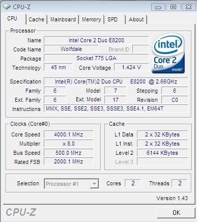

latest official bios works fine with wolfdales.
http://i14.photobucket.com/albums/a3...774800x600.jpg
http://i14.photobucket.com/albums/a3...0mod/4GJPG.jpg
