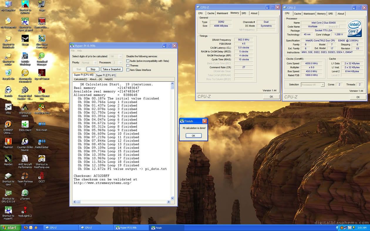

My 8400 only wants to run with 500FSB. Anything lower or higher, and it goes unstable. My memory can eat 533x2 (Corsair 8500C2D) so it's not a problem. Motherboard is a P5K Premium.
So far it's running at 1.400V, 500x8, stable, low temps (watercooled, so temps are not limiting factor either). I am disappointed at the voltage needed to reach that point... And puzzled at the unstable 533, 445, 450 FSB settings (i put the proper divider for memory every time to keep it under 1066).
I am positive it's a CPU problem, i tried lowering the CPU multi, the motherboard would do 533MHz FSB without any glitch.
