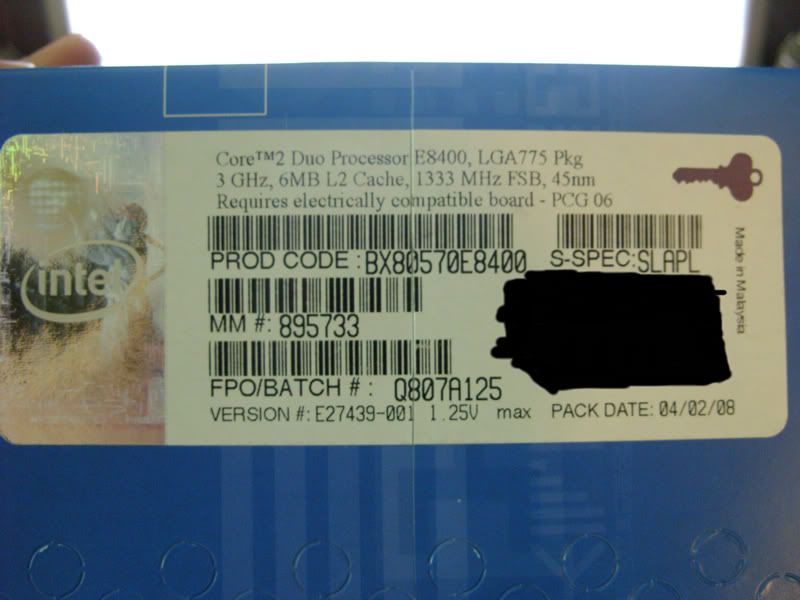

@Tibu: Interesting, max rated voltage is now 1.25V, mine has 1.225V.

I just got my E8400 Batch #Q808A256 3/260/08
