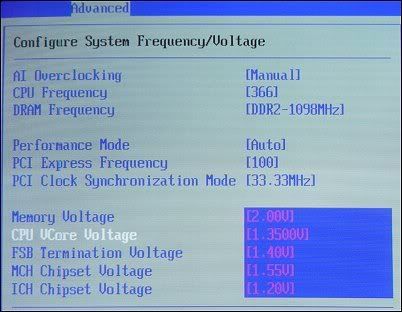

E6700 with P5W DH, Corsair PC 8500...does this look fishy to you?
link
EDIT: I just tried and couldn't get the PC to post.

http://i11.photobucket.com/albums/a1...6FSB_Bios1.jpg
Here is my setup using PC 8500
http://i11.photobucket.com/albums/a1...Bootup_306.jpg
Here it is booting up.
