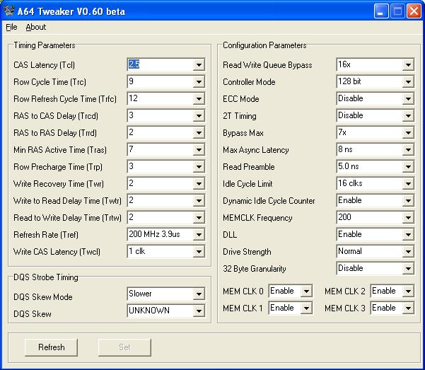

My new LEs are not stable @ 250 Mhz! I cant be the memcontroller.. Every memcontroller nowadays makes 250 Mhz! Its a Toledo and i know many people who run them with 300 Mhz and more, CPUs of the Same Manufacture week!
http://www.computerbase.de/forum/att...6&d=1124478231
With these settings it is unstable 250 Mhz and 2,7 V... What can i try to get it stable!?
Your Picture is not working.Quote:
Originally Posted by WulleWuu
Indeed, 250MHz is a bit low for 1GB LE. There are two things that might be happening to your memory. 1. It is defective 2. There is a crucial BIOS setting wrong.
To test it, set everything to AUTO and vddr to 2.7v. First try two dimms (orange banks), which you might already have done. Then try one module a time. You can test with Memtest86++, but i prefere Memtest 3.2 for windows or Prime/SP2004 -> RAM stress for a while.
If the settings in the guide are not working, then their must be something wrong with the memory.
If the memory is defective, please ask RMA by emailing rma@gskill.com
Tcl:2,5
Trc:10
Trfc:16
Trcd:3
Trrd:3
Tras:7
Trp:3
Twr:3
Twtr:2
Trtw:3
Tref: 200Mhz 3,9
Twcl:1
These are my settings! The rest i auto!
I only get 2 errors in memtest.. in Test 5 at the end of test 5! What does this mean=
