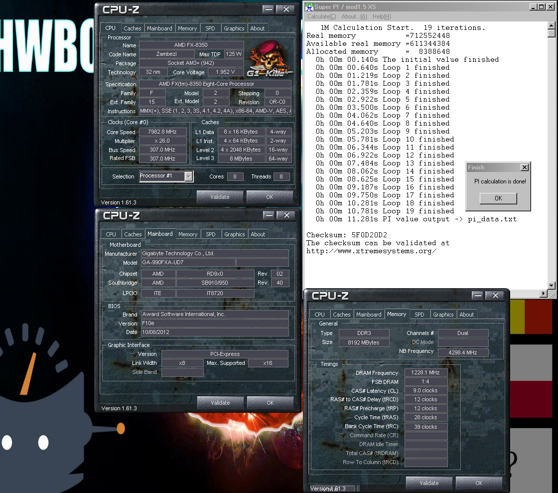

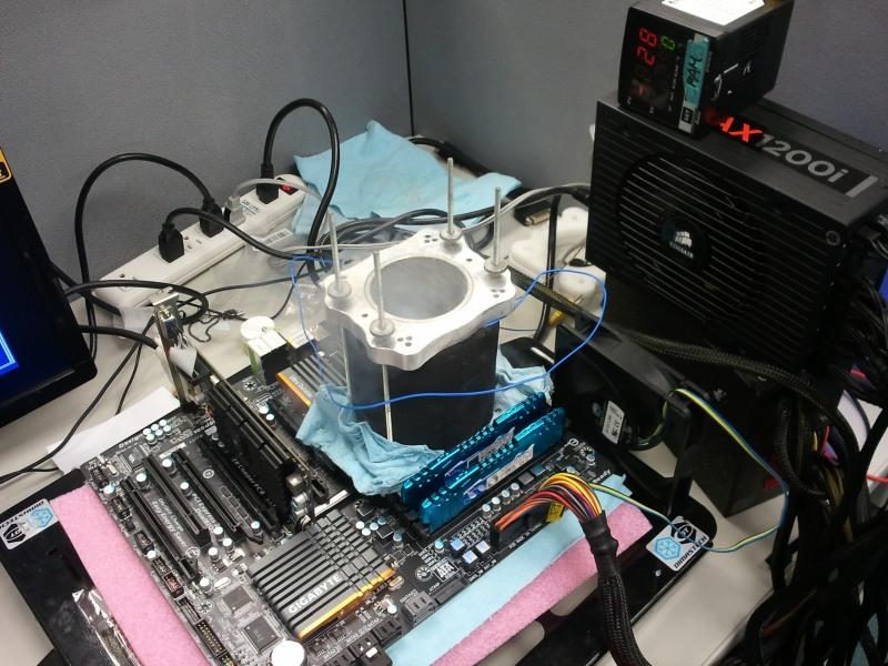

Vishera looks better for LN2 OC too. Looks easy to get 8 GHz than Zambezi Bulldozer. I hope, someone will broke record of FX-8150 with new Vishera chips in freqency...I wish really some very great low VID chip for it :)
No idea why everyone is being so conservative. I've not had the slightest issue pushing the memory over DDR3-2600 and performance is pretty okay too ... if you use high HTT frequency (same issue on Bulldozer). I'm going to do a couple of 32M runs next week - seeing how high I can go with mem/nb - and probably a pifast too. Piledriver is a lot of fun :).
By the way, since the key to both Bulldozer and Piledriver performance seems to be memory divider (see: http://hwbot.org/forum/showpost.php?...7&postcount=37), I think I need a different board. UD7 is limited to ~340MHz HTT (tested different samples of motherboards and CPUs), but it seems the UD3 might be pulling a little better (300+ on air compared to 275 max of UD7). Hope to get my hands on a UD3 next week :).
Not sure if it's a lot easier - tested a total of 3 CPUs so far and the two others did around 7.8GHz boot into OS whereas this one goes to boot around 7.91MHz easily. A lot better than some Bulldozer CPUs, though :D
I had no luck with Bulldozers...the best one was 8320 and hit about 7700 MHz, but OBR kill my chip with high voltage after :D...ANd others 8350s/8320s had only limit around 7200-7400 MHz...
Vishera? My first Vishera easy 8 GHz, others looking similar (others I compared only with AMD liquid cooling)
