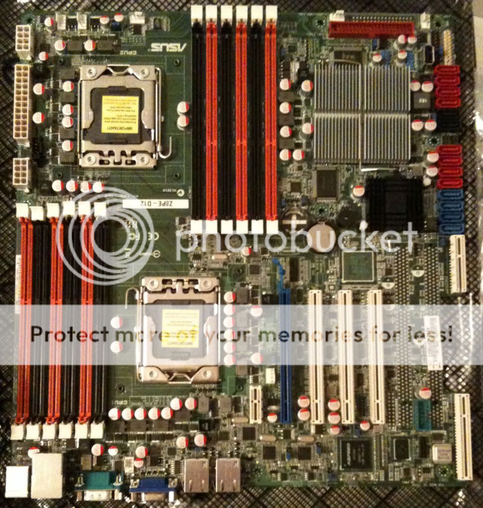

I decided to build one dualie with two L5640's in an Asus z8pe-d12 that I bought open box from newegg for a good deal. It won't overclock but I figure i'll stick two of the more problematic L5640's that I have in it and run it at stock clocks and probably not even in the farm. I think i'll build it out eventually as a linux desktop machine/cruncher with a... case :eek: and everything. I'm expecting it won't work with the 32nm 5600's xeons out of the box and expecting to have to take apart my dual E5520 (same mobo acctually) to update the bios with those chips. Should be good for ~8500-9000 boinc ppd. Not putting this in the farm will also free up more space for more rigs in the farm (which its looking like I'll need to get a steady 100,000ppd, if I build everything I have now I think i'll be falling a little short in the 95,000 ppd range.) Another gulfie... or maybe something different like a SB might be a good final piece later to complete my goal... I'll have to think about this.

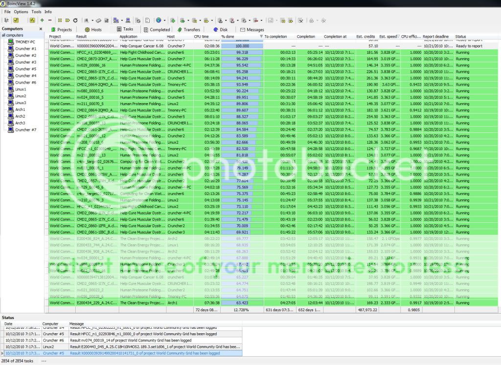

*edit for some boincview p0rn*
My current home setup is 14 hexacores; L5640's, 970s, and 980x's. In addition I also part time crunch with my dual Gainstown rig at my office. 6 Linux rigs and 8 windows 7 and Sever 08 rigs.
http://i399.photobucket.com/albums/p...dboincview.jpg

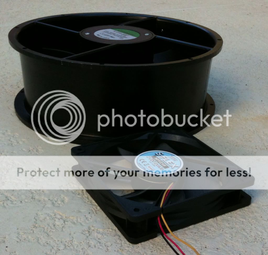

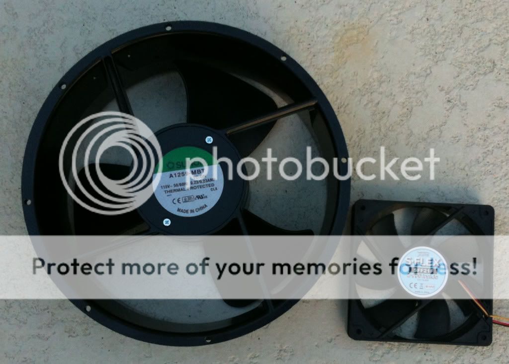

Comparison shot with a 120mm S-Flex; the Sunon is a 254mm (10") fan:
http://i399.photobucket.com/albums/p...ct/sizing1.jpg
And here's the real money shot, 3.5" of depth for awesome-sucking static power; Girth and Length!

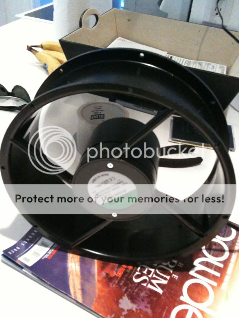

Test Run on my counter, the fans run at 120v and use only 26w which is nice and push 660CFM at a moderately noise 50db. This picture looks like a random object search; find the bananas, sun glasses, pliers, passport for bonus points!
http://i399.photobucket.com/albums/p...ct/TestRun.jpg

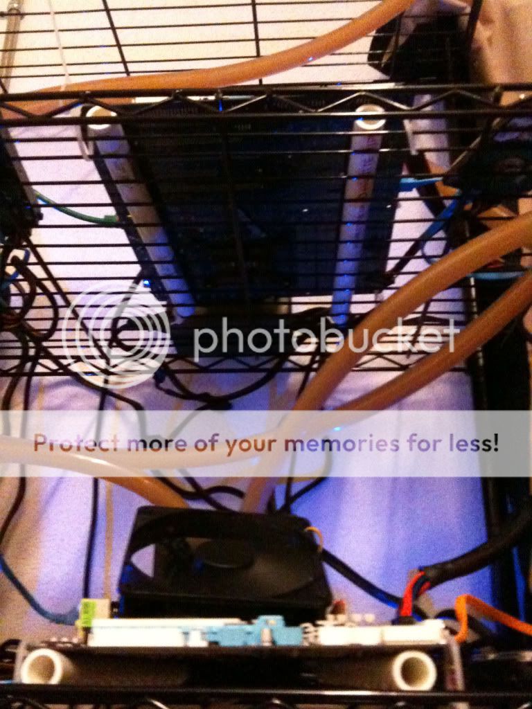

This shot is for OneX who has called me out on not properly insulating my boards from the rack TWICE! I put 1' sections of PVC piping under the boards and zip-tied them down to the racks. Less than a dollar per board and I still get good airflow to keep the back plate cool.
http://i399.photobucket.com/albums/p...insulation.jpg

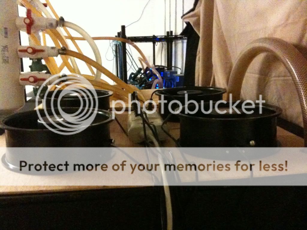

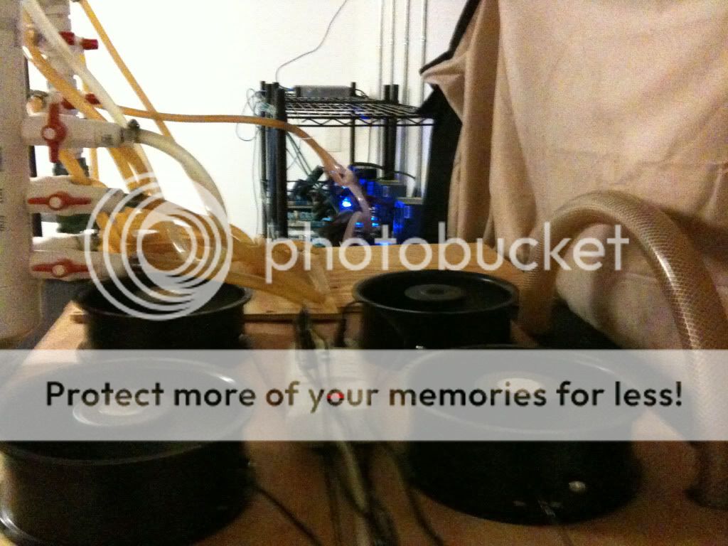

Some quick work with the saws and I rigged up 4 of the 6 fans for a temporary mounting solution. Each fan weighs around nine pounds, nothing is holding them in place now but they are well balanced so it should be good enough for a while until I finish everything up later. The fans work awesome, they are sucking and blowing nicely :)
http://i399.photobucket.com/albums/p...ct/action1.jpg
http://i399.photobucket.com/albums/p...ct/action2.jpg

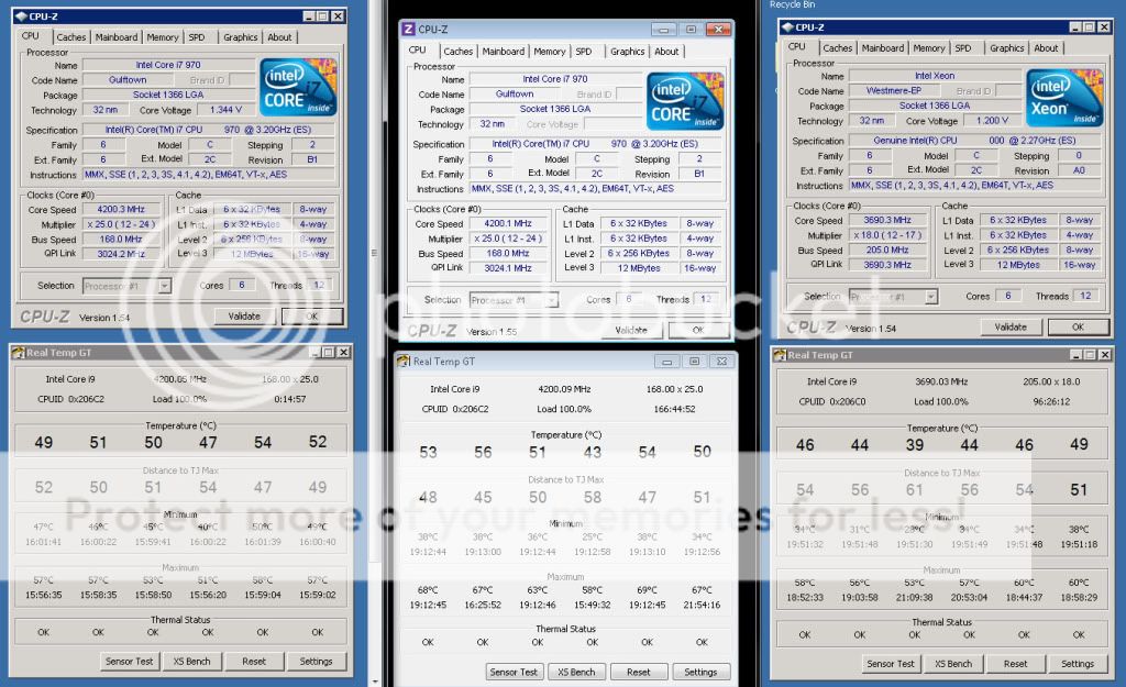

And for a closer, here is the current result. Temps dropped a lot and so far zero heat build up in the garage (look at the old real temp max temps.) Gotta start working on getting everything under diarr.... uh I mean H20 before Supercomputer Week!
http://i399.photobucket.com/albums/p.../farmtemps.jpg
