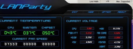

does someone already see this skin for smart guardian :
http://i31.servimg.com/u/f31/11/51/44/49/525e1210.jpg
or, someone knows a website to find skin for smart guardian.
thanks, and sorry for the out of subject....and for my bad english (french guy).
