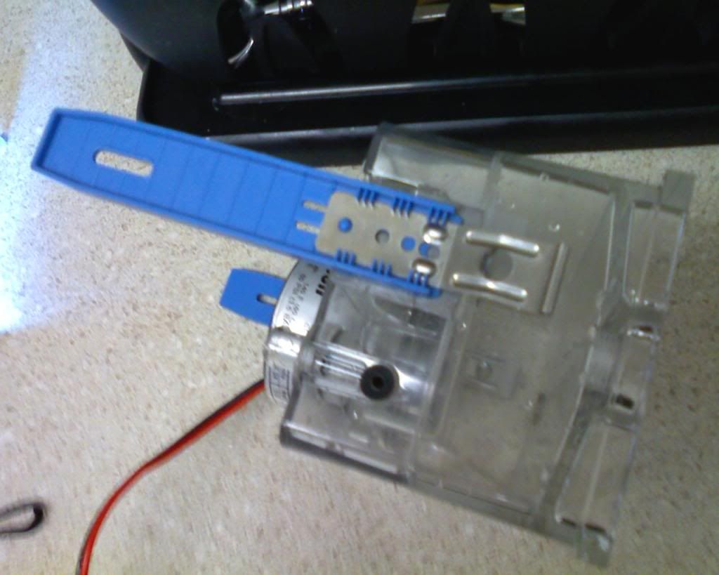

is it normal that this crap res keeps leaking from every mounting hole ????
surely u have to do something here, trying to fix it my self because hell im not gone wait for a RMA or something!!!
if u want some pics where my problems are boxgods let me know its just pissing me off that i payed 60€ for somethings thats leaking from day ONE.
Are you using BP, Koolance, etc fittings or the included fittings?
If you are using any of the other fittings you have to use a thicker o-ring. The o-ring is a USA standard #9. Some guys from overseas have had issues finding that exact o-ring. Vapor did post measurements, but I forget exactly where.
I did a quick google search and found these measurements. I'm not positive they are correct though: 5/8"OD x 7/16"ID x 3/32" wall
Some guys have taken the o-rings off the included fittings and stacked them on the o-rings from the other fittings and haven't had an issue that way. :up:
Or another question is, did you tighten the mounting points too hard? Is there any cracking or spalling around the metal female threading points? I mean, looking at mine, I can't see how it would leak around those unless they were cracked because they look fully encased in acrylic.
nothing to do with leaking :p:.
yeah they where cracked there, i did not tighten them to hard.
first mount = cracked very easy, sure crap for me.
i cant find my self in where that should be normal! when the pump is running no leaking, when its shutdown leaking.
same for pre packed fittings, pure crap (not even bother using them)

It was way back. I got one of the first T3s with the yellow band and had hair line fractures around the band. The fill port holes weren't drilled properly either. There were small chips and the countersink wasn't uniform. It looked like the bit was rolled during drilling.
Its all good though. Brian and Boxgods sent a new one and it has worked perfect ever since. :up:

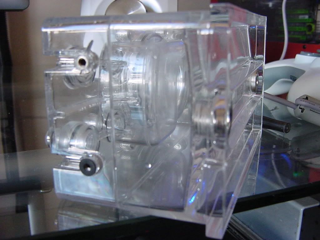

I just heard demand is still big for this reservoir so much that my danish retailer cant get hold of any, is this true?
botem one
http://i3.photobucket.com/albums/y90...r/DSC01412.jpg
top one
http://i3.photobucket.com/albums/y90...r/DSC01413.jpg

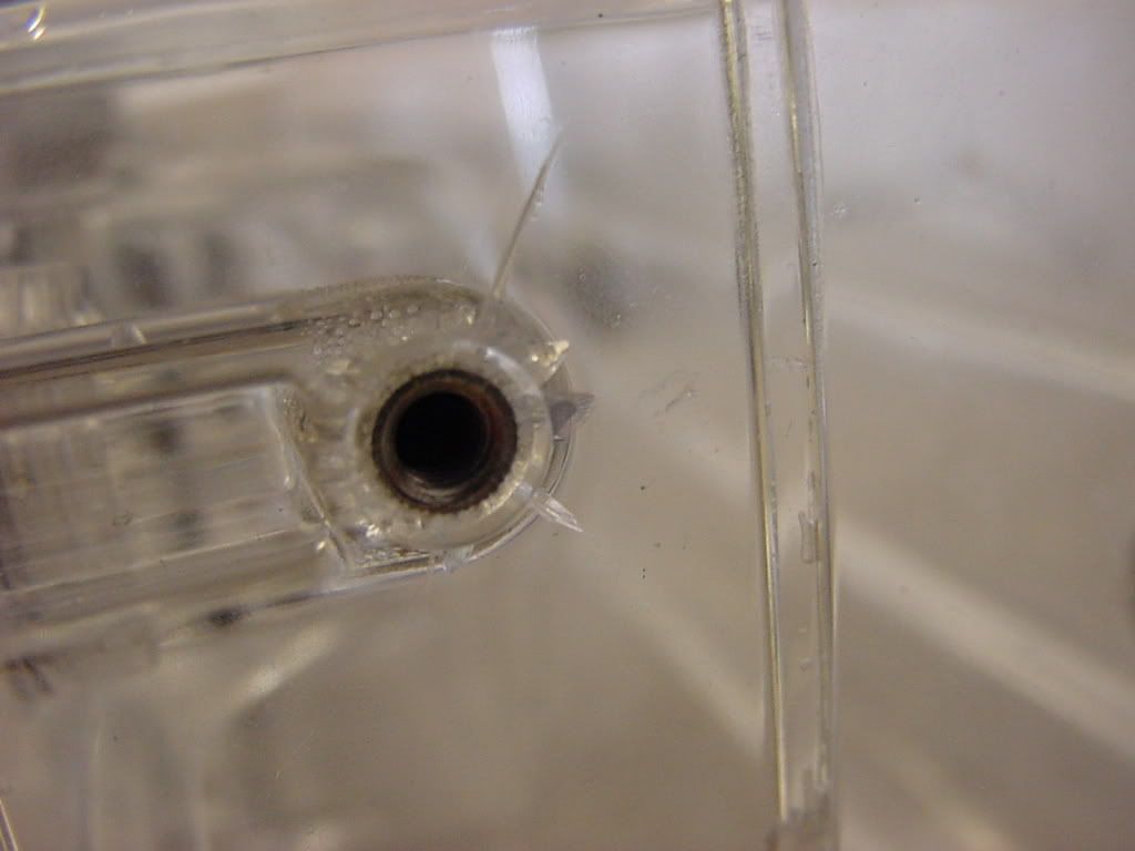

u can clearly see thet the coolant is coming out, hairline crack at fill port in front also.
had to gleu these up some, but not 100% leak free. it whas gleuing or no pc for me.
the other side is giving away now to and started leaking also this night!
[/QUOTE] can clearly see thet the coolant is coming out, hairline crack at fill port in front also.
the other side is giving away now to and started leaking also this night![/QUOTE]

My system is still running, will get pictures shortly. My issue Is a little different than his I think. Looking more closely (when facing the front) the upper right hand corner where the mounting hole for the backplate and the mounting hole for the side are close to each other. When I turn the system on it will suck air in through there and when I turn the system off I get rather fast leak that goes between the backplate and the res and then drop down onto my CD drive. It is NOT coming from the pump O-ring, the leak is outside of the O-ring but still behind the mounting plate for the pump. Where could I post a video? That should show it best I think, but may be hard to capture the water moving behind the plate.
http://www.xtremesystems.org/forums/...&pictureid=838
1: This area will get clear like area 2 when It starts leaking
3: Behind this is where the air/leak are coming from.
Hard to see the air bubble that is there, but that is where it will suck in all the air from and then push it out when off.

I just seen this in one of your photos it is cracks at the mounting point, see it in the bottom right corner?

As for the cracked picture from Brian. That is very likely an original test mule from the batch that was tested to failure and for compatibility. Not making excuses, I can tell that because it has the pretty aqua compression fittings which were also the test parts.

We are trying to help him and that damage that he showed us looks like the results of Glycol. He showed us the coolant he used and it reads that there isn't any glycol in it, so the warranty isn't void. The only thing he can do is get a hold of Brian and RMA it.
Unless something got lost in translation, he doesn't want to RMA it, so only other option is to trash it and get a new res.
Not at all. Does your T3 have a 1/4" pump mounting bracket or the new 3/8" mounting bracket? We switched to the 3/8" (Yes CM I now got your meaning) and allen screws to prevent the tendency to over tighten those screws. The problem is that once the bracket has touched the T3 body any further tightening does nothing but subject those brass inserts to high loading. With the allen screws it is just harder to over tighten them. I am not saying you did of course, but if a user does use one of the chemicals that can cause cracking, the cracks will form in high stressed areas first--like the inserts.
The T3 is a very sturdy well made acrylic and polycarbonate product but at the end of the day it is still a plastic part--worse a clear plastic part. It puts me in a tough spot because ANY clear plastic part will have issues with glycol, alcohol etc and will always loose the fight with an over tightened screw--that's why we use the inserts.
We are coming up on two thousand T3's now in service...and unfortunately people without issues rarely post :(

trouble with this Primochill Typhoon iii , when I unpacked it last week I noticed a small imperfection in the front that looks like a hairline crack and also saw another in the metal screw anchors in the plastic didn't think much of it .. filled with water early today and surely the crack by the anchor starting leaking , I was thinking of epoxying it , but it should be covered under warranty , what do you guys think would be better to contact primochill directly or frozen cpu , Ive dealt with frozen cpu before but I would see it taking longer to get back to me ?
Positive thing though when this pump was running , I couldn't here a thing and was on setting 5 with swifttech pump
http://i84.photobucket.com/albums/k7...c/DSC00010.jpghttp://i84.photobucket.com/albums/k7...eme%20pc/1.jpghttp://i84.photobucket.com/albums/k7...c/IMG00122.jpg
The scratch on the front is a molding imperfection. I just got a new batch of 1000 fronts in from China and even though they swore up and down they had polished it out...its STILL there. Not sure what Brian/Primochill is going to do but I am guessing ship the molds to a new company =( I know it doesn't show when filled but if nothing else I get tired of saying "yes we know it's there, not a problem" lol. (Meaning China not customers as obviously not everyone reads the forums and knows about it.)
As for your crack...no way you should epoxy or try to repair that. Start a RMA ticket and get it swapped out. They are also moving to nylon screws and will be including a metal case length and an acrylic case length that will also work better with those slide in rail type cases.
Short answer, do not repair, just RMA.
Did that one come with the 1/4" thick pump mounting plate or the newer 3/8" version? Curious which shop it came from...also, are you running that with just the one set of rails? I am not sure just one screw per side is really enough and the T3 might want to rotate since it is sort of like being on an axle with just one screw per side.
I can confirm that the crack in the front is not an actual crack.
When the res is filled it really does disappear.
I put a black T3 faceplate on and it is now fully gone.
Just like magic.
For me the molding imperfection was a tiny complaint on an amazing product.
ok boxgods trying for rma called frozen cpu , they said for faster service to call Brian at primochill, so hopefully he can help me out ... luckily i didn't epoxy.... just didn't want my main pc out another 2 weeks it good to hear they're changing out the screws for nylon ones , but I had to use 2 way tape cause of the position of the screws and yea one rail definitely lets it rotate a bit but once i put in the cdroms she locks in , the back piece is the 1/4 but it was pretty sturdy and held my swiftech pump great .... all and all this reservoir was a bit of a problem , but after i heard it running I was amazed at how well it worked , hopefully if I can get a another one Ill have my confidence back in it
