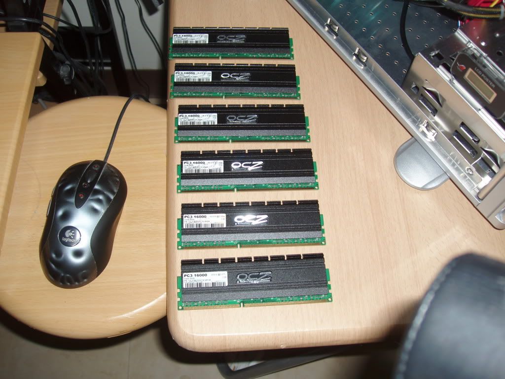

Thanks for trying it out Blaxtr3m3. I guess the strain is on the IMC itself whether it be 6 Gig(3 sticks) or 12 Gig(6 sticks). Anyway still looking for a good water cooling setup. Anyone have any suggestions? Thanks in advance.
Psygnosi:D
http://i572.photobucket.com/albums/s...g/P8140001.jpg
