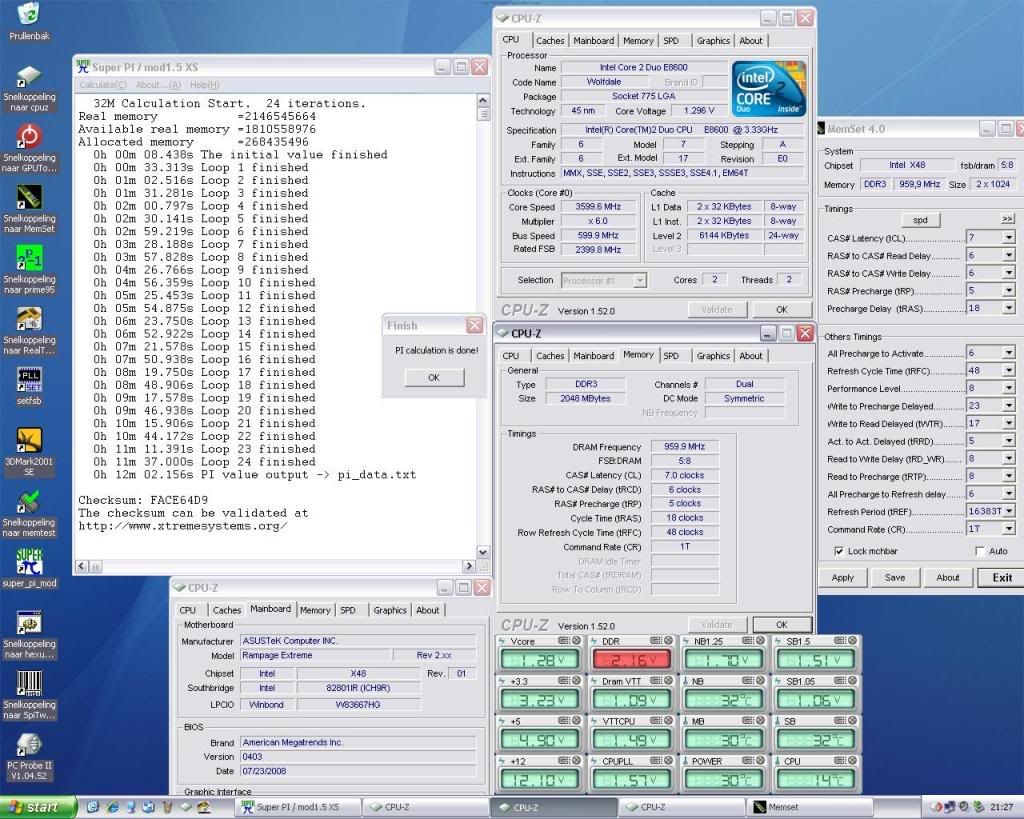

Here's 600FSB, PL 8 and some nice ram frquency and timings --32M proof:
http://img.photobucket.com/albums/v6...8untweaked.jpg
Run is completely untweaked, just stabilty testing.
