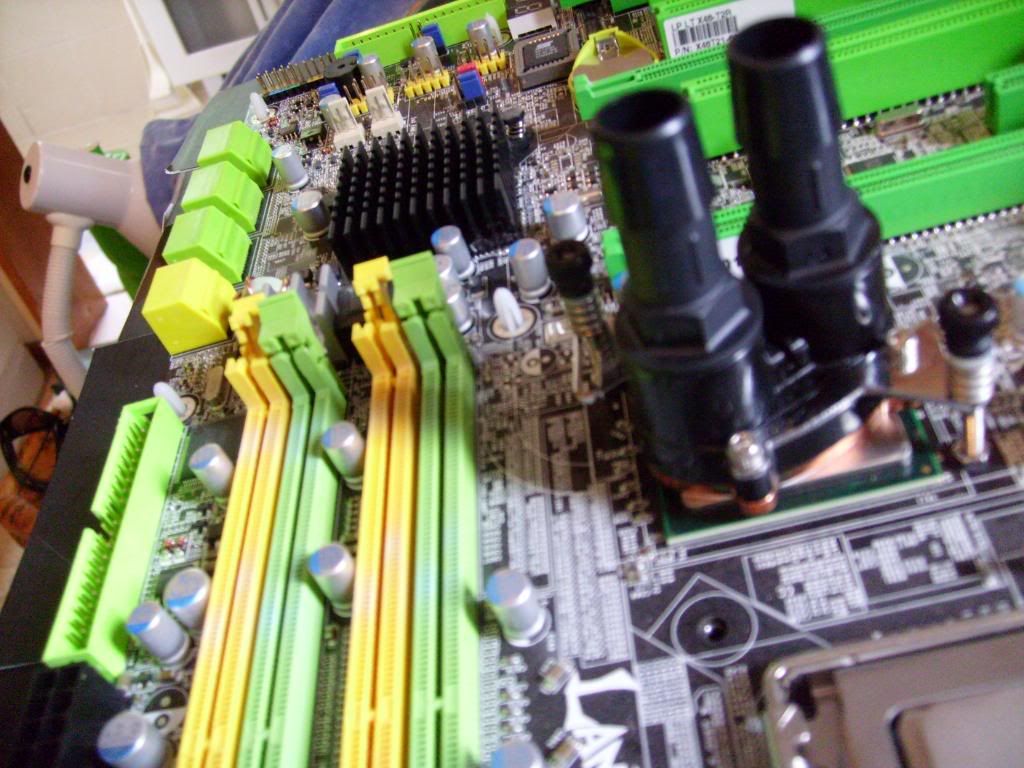

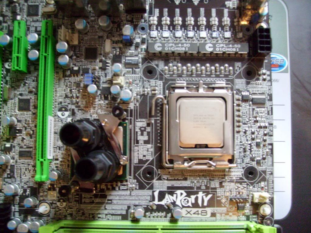

i did warm it somewhat but with mosfets i didnt really need to since there such small areas. it was actually quite easy to spread i didnt have a problem at all.
i wish i took a pic of what it looked like before, it was terrible lol gunk all over the board , i mean alot of gunk to. there was none at all on the mosfets either.
looks alot better now as u can see in the pic.
also added a mcw30 block to . did i fit it on right? had to use amd connectors and it had to go on an angle. is that ok?
http://i295.photobucket.com/albums/m...S6300258-1.jpg
http://i295.photobucket.com/albums/m...1/S6300255.jpg
That's fine. I have it on my sb using the same mounts.
EDIT : Errrr if you are going to use the Swiffy barbs, make sure to use a o-ring/plumbers tape because I don't think they have a o-ring.
metal barbs are hit and miss on those, they arnt tapped for them and they need really long threads so it depends on what barbs u can use from how your tops on the mcw30
After looking through my photos to find some nude shots, I'm using Bitspower barbs [DD have identical ones] with no leaks. I know all about barb issues though with my SW16. D-Tek didn't fit, BP leaked so I ended up using some Enzo barbs.
