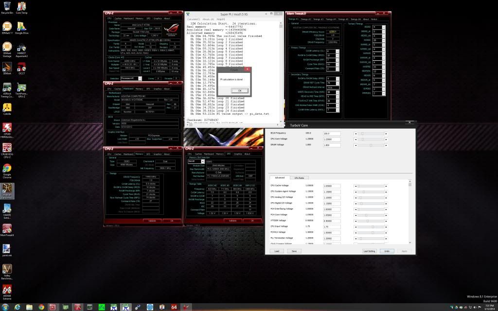

First test with these, AFAIK these are my only BBSE that can pass the tight 2400 preset on Maximus VI Extreme.
http://i947.photobucket.com/albums/a...ps756fca60.jpg

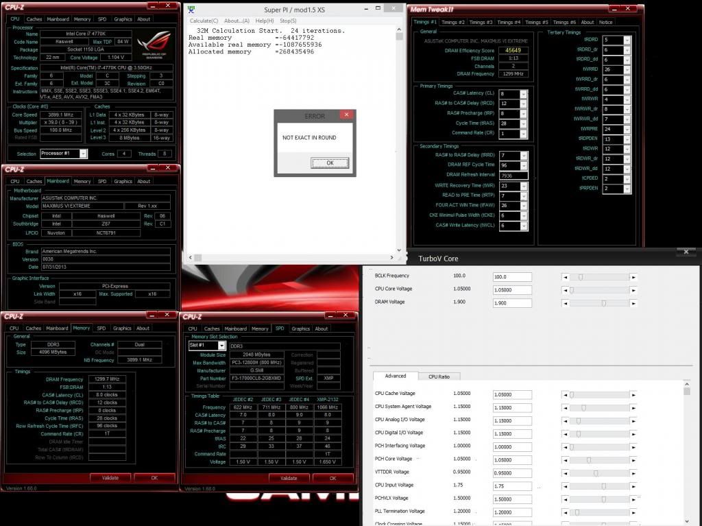

Struggling to run 2600 CAS8. Suggestions?
http://i947.photobucket.com/albums/a...ps3e0cf2fd.jpg
I see two possible reasons:
- IMC can't do 1300 on PSC/BBSE at 1.15 IO/SA;
- wrong timings - what you're running is a PSC profile and, from my experience, BBSE don't like running too loose;
You can also try reopening pi.exe and giving 32M another shot, sometimes it helps.
