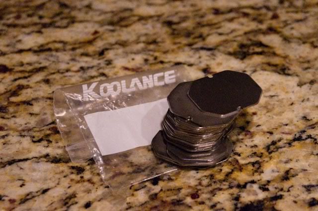

Plates are in house! (thx Koolance) Cutting begins tomorrow
http://i118.photobucket.com/albums/o...e/IMGP0462.jpg
:up:Sweet! I look forward to the testing of the various different cutout styles.

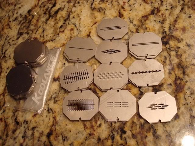

Bei, did you cut one out murdermod Serpentine-style?? lol
http://www.murdermod.com/components/...ze=75&fileout=
You can also experiment with different forms of cutouts .. eg. one big round, or two smaller, or one ellyptical ..
OK guys....
We can offically kiss vapor goodbye for a while.. because he will be testing all that and probably will disappear until its done!
:rofl:
10 injectors so far, and he does about 5 mounts each, = 50 mounts total... Eric... thats a LOT of MX-2
I'm sure some will be eliminated after the first mount and performance is abysmal.
im sure he will still do at least 2 mounts to test for mismounts tho.
NaeKuh: and Vapor will need to test those plates with different TIMs aswell .. eg. ones with cure time of 48+ hours :D
