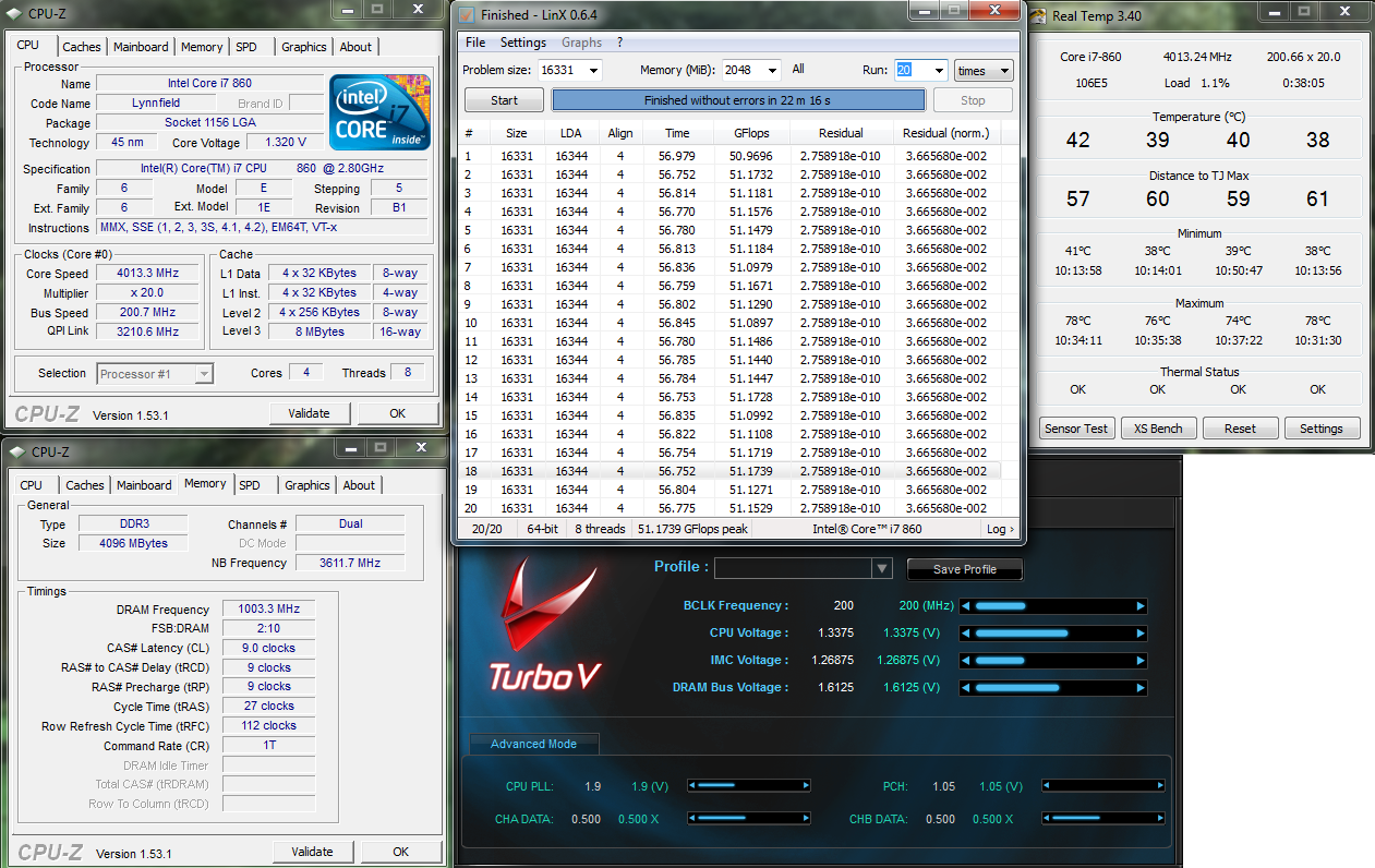

4GHz Stable with HT on.
CPU: i7 860
Mobo: Asus P7P55D Pro
Mem: 4GB G.Skill Ripjaws DDR3-2000
20 Linx Pass. Max Temp on any core: 78C with room temp of 29.5C (Puerto Rico on a not cool but not so hot day).
Watercooling: Apogee XT + XSPC RX360 Rad
Voltages:
CPU: 1.32v (real)
IMC (Vtt): 1.27v
DRAM: 1.61v
PLL: 1.9v
PCH: 1.05v
http://i59.photobucket.com/albums/g3...B/1e7d7733.png
