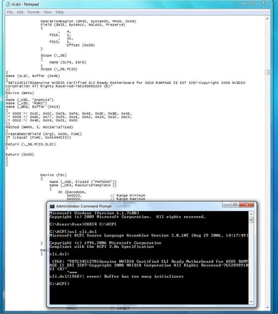

Trying to compile the sli.dsl but I got an error, anyone have qlue what I´m doing wrong.
http://i282.photobucket.com/albums/k...me/RESLIP1.jpg

hmm tried to set up die MSI 790FX-GD70 but got the same error discribed earlier in this thread by another user:
tried also the latest ASL-version, but still the same error. could it be an issue of the AM3-mainboard or the mainboard vendor? The "If" looks normal to me :shrug:Quote:
3866: If (ECEN)
sli.dsl(3866): error: unexpected ASL term type
the SLIC starts at line 11xxx, so it must be another problem.
The ones with issues should host their original DSDT dumps ( the initial .dsl file ) on RapidShare and provide a link here if you want to get any decent help :)
