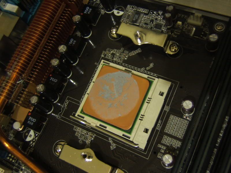

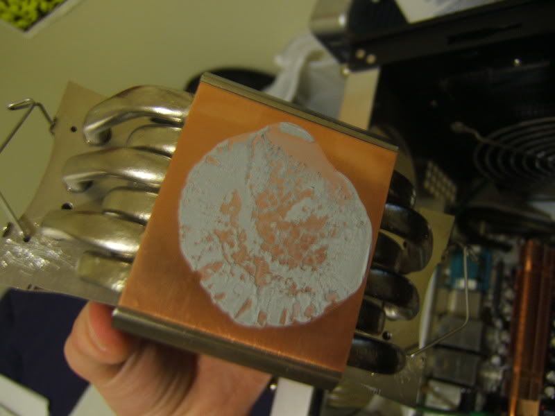

due to Bob saying that he noticed a drop in temps from the Shin Etsu after 22 hrs and having had mine on for 5 days and seeing an increase in temps I decieded to pull the mount and switch to the IC D7.
heres what I found when I pulled off the heatsink
http://i37.photobucket.com/albums/e9...e/DSCF3050.jpg
on the CPU
http://i37.photobucket.com/albums/e9...e/DSCF3054.jpg
i'm actually surprised with this, imo, it spread fairly well an the empty spaces on the hsf match up with the covered areas on the ish.

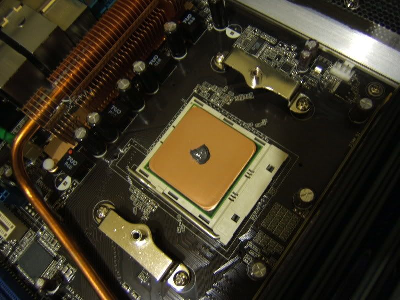

heres my blob of D7
http://i37.photobucket.com/albums/e9...e/DSCF3059.jpg
