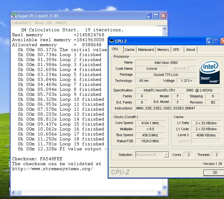

My little results so far...
http://www.sspmustang.com/OT/x3060/4...wn-1m-run2.JPG
http://www.sspmustang.com/OT/x3060/4...n-32m-run2.JPG
Yes, the 32m time is slow... I clearly only did it to show stability.

posted in the xeon thread too, but it applies here...
http://www.sspmustang.com/OT/x3060/3...os-runlow2.JPG
1.34v prime @ 3600 :)
