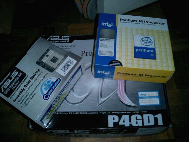

Finally after two weeks of struggling i got my p4gd1 and 760 to work :banana:
But i found out i am missing one of these white thingys that hold the racket(the square black thingy where you attach your cooler) on the socket, so basically i cant try huw fast my dothan could go :(
With W/C i have managed to get 45c idle and aroun 60+ stress temperatures :zombie:
Maybe better luck tomorrow. Im gonna do some ghetto patent on it. Atleast i can surf the internet and maybe try some gaming tonigh.
Soo hopefully tomorrow some serious overclockings. ;)

*lol*, I guess we're lucky, we have an abundant supply of P4GD1 here =)
Here's all my sealed Pentium M + P4GD1 + CT-479 system: http://sleektech.nl/~dm/temp/ct479/pm-trio.gif
I am still too lazy to put them together :(
