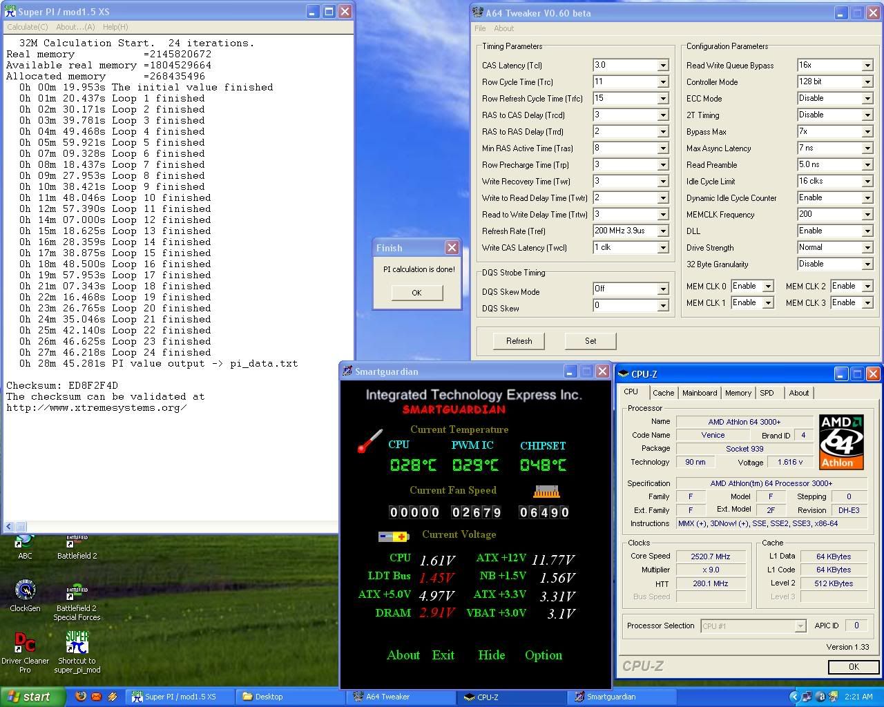

Tighter timings were behaving better than looser :wth: I also took the time to find the optimal drive strengths. To my surprise, it ended up being at dram drive = Level 8 & data drive = Level 3 :confused:
276.3mhz @ 3-3-3-0, 2.8v

Trying to push further forward, I was met with some erratic results. I'm sure some of you guys have seen things like this before. Makes me go :banana:'s
22 loops? :wth:
22 loops again, but not enough! :stick:
