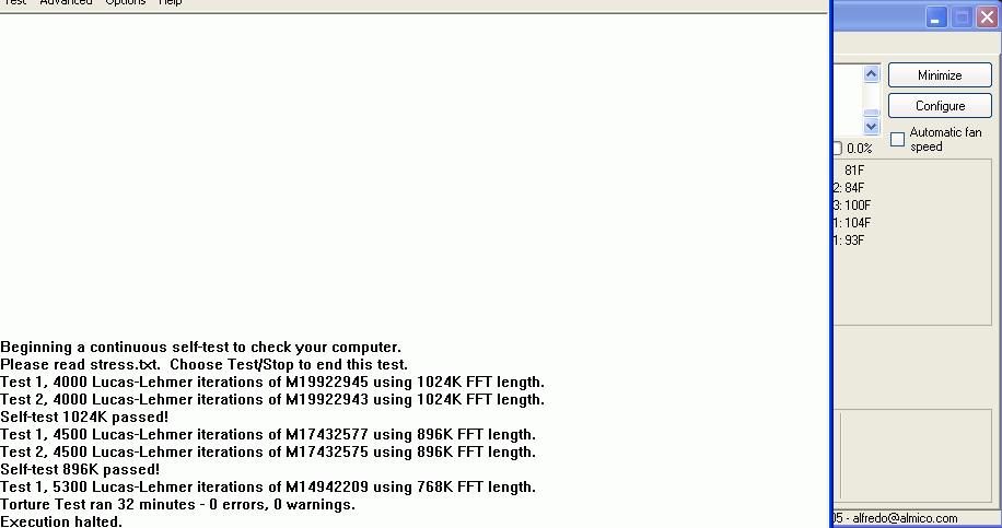

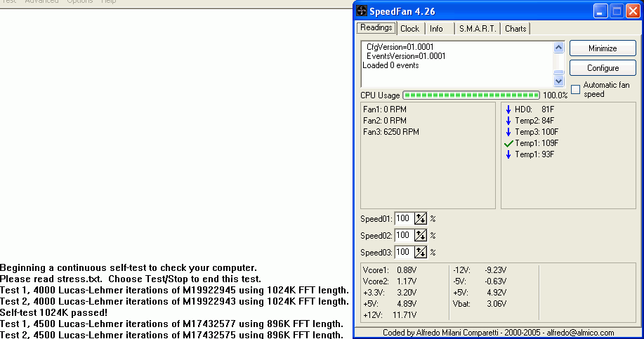

30 minute heatsinkless prime95 run:
http://img.photobucket.com/albums/v6...rime951GHz.png
and SS after i halted the run:
http://img.photobucket.com/albums/v6...1GHzhalted.png

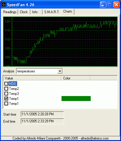

Temp curve for going from Idle (95*F) to fully loaded for 10+minutes (118*F).
http://img.photobucket.com/albums/v6...pcurve1ghz.png

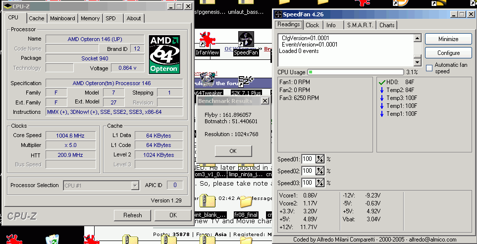

SS after getting done with a UT2003 run:
http://img.photobucket.com/albums/v6...noheatsink.png
These opterons run cold as ice, when on low voltage! Thanks for the suggestions of running with no-HSF!

The temperature graph above was actually for 1.0V. The graph below is for 1.0v, and 1.2GHz.
http://img.photobucket.com/albums/v6...e1oint2GHz.png
The next graph is for 1.4GHz
http://img.photobucket.com/albums/v6...1point4GHz.png
Going from 1GHz to 1.4GHz only gained 10*F fully loaded. I dont have my picture of a 1GHz run at 0.9v, but you can see from some of my other screenshots, and from the video, that my loaded temp at 0.9v is around 110*F. Increasing voltage from 0.9 to 1.0 gained 10*F.
My cpu could only do 1.2GHz or so on 0.9v, and only a little over 1.4GHz on 1.0v. I think most CPU's (non-opty's) would take more voltage, and therefore put out much more heat. But who's to say.
