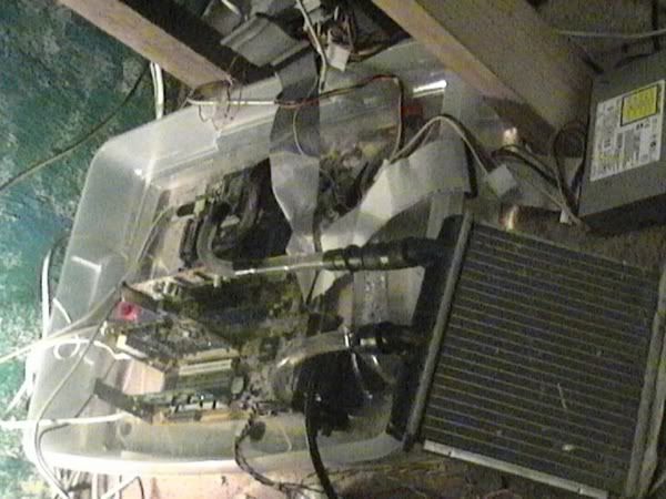

as for a pic of the cooling its ugly but heres a pic without fans on radiator just so u can see it
http://img.photobucket.com/albums/v4...r/DVC00371.jpg

ohh and for pics i attached one above in previous post i dont have any more pictures of it up close but i will soon
basically the mobo is in a rubbermaid tub with like 30 bottles of "unscented delicate baby oil" with a submersable pump capable of 200gph water and a unknown heater core and a large fan and shroud to cool the oil
theres one submersed fan stirring the oil around and the pump drops the cooled oil onto the stock heatsink
temps are 37c full load running seti@home classic on normal priority not low
29c idle just above ambient no cnq used
ive given some thought to my future cooling solution and am thinking of putting a 250 watt pelt on the cpu using the stock hs after machining it thinner and then let the oil cool the pelt and the pelt cool the cpu and there will be no condensation because the pelt has no air under the oil :)
thx jake.
im concerned that this may create much higher oil temps though but not sure since there will be cold being produced as well??? mabye i will have to add a larger pump and a second or larger radiator to the equasion

As for your pelt idea:
You will still need isolation on the cold side of the pelt. Peltiers work by transferring energy from one side to the other. They do this in a very inefficient way since energy is constantly pooring back to the cold side. (like mopping with the water running)
If you put everything in the oil without the isolation you will provide an alternative route for the energy to flow back completely killing the pelt's performance level.
It seems you have a lot to learn about energy flows.
The setup you are now using is less efficient then using this radiator just for WC, this is because you are also dumping the energy of the entire system into the radiator whilst otherwise only the CPU energy would be.
I don't really see the point of oil systems without sub-zero tempratures anyways, so just switch over to WC. Also put some fans on the radiator...
Warning:
I've had oil systems running before:
After a couple of weeks/months the dust coming into the oil turns the oil from non-conductive into conductive killing everything (and becoming a hazard if the PSU is in there).
So be sure to seal of the system from the outside world completely (I used a sealed boxed with foil wrapped around it and mine still died after 4 months, I measured the oil to be conductive at that time)

also, the viscosity of the oil makes it not flow so great... properties of air are better for cooling a processor, motherboard cooling is probably better w/ the oil, but processor, it just slows things up, unless you try to supercool it

ive run this system now for 6 months no problems the oil isnt conductive yet..
no seal
i have dust in the solution i can see it at the bottom of my oil but no conduction i imagine it matters what type of dust is in the air around here its just gravel /limestone
as far as getting better results from wc than oil cooling where do you think i got the oil coolong idea ive used wc for 5 years on various systems and they dont keep the cpus nearly as cool as this oil stsyem does its all about how you set it up
watercooling does not surround the cpu (the reason for my better temps with this than wc)it does not cool my ram it does not cool my southbridge does not cool my northbridge does not cool my vid card does not cool my vid ram...
if i only wanted a cool cpu mabye.... but it seems to me wc is inefficient in the way that it does not surround the cpu like this does ive never come so close to ambient cpu temps with wc..
and about the add some fans to my radiator comment......
if you read my post with the pic .....
{pic of the cooling its ugly but heres a pic without fans on radiator just so u can see it }
the fans were taken off so it could be seen ...i use a large fan with a shroud
cpu temp with oil as i post is 31c no CnQ
full load temp=36c
cpu at 2.5g vcore 1.63

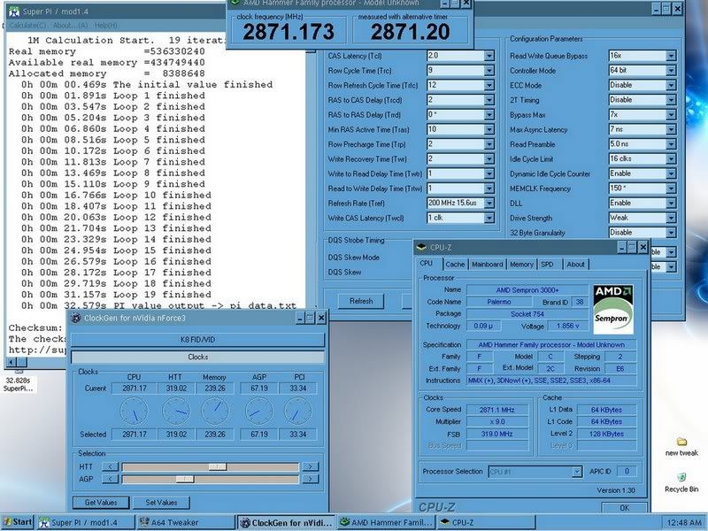

You're willing ot bet someone has you beat? Good bet, check out post 19.
i take it i got my ass whooped by post 19 and now nobody gonna bet me :P
(edit) What post 19????? LOL ur wasting me time!

Also: Dust conducts electricity very much so, it normally consists of a great deal of salt, 70% human remains and the rest is all natural minerals. All of these elements conduct electricity.
If you think oil cooling of the entire system has better overclock results then the same cooling system filled with water only cooling the CPU you are sadly mistaken. In my experience extra cooling on the chipset and rest of the system on a K8 system has little to no effect to the maximum overclock. When cooling the CPU you are also cooling the clock generations circuits and memory controller inside, those combined with the memory and quality of the motherboard/power supply determine the max overclock. And you don't need to cool the sides of the CPU, the actual CPU is only a very small core in the silicium. The rest is just for connecting that core to the mainboard.
