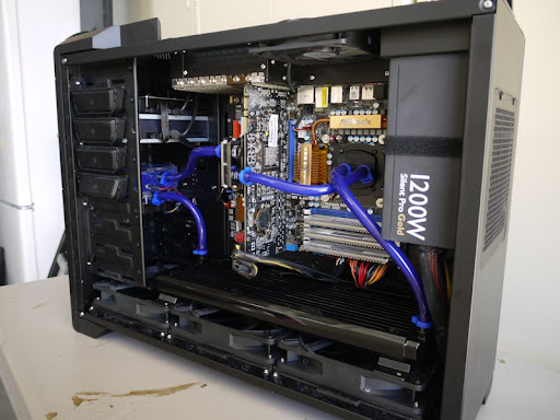

How large of a difference do you think the single radiator at the top makes? I think I could do the same in my rig.
How did you mount the bottom rad on the fan brackets of the Raven? I had to dremel an aluminium plate with 18cm hole spacing to fit the fan brackets and 14cm for the rad.
Your cable management is superior to my cable management.:clap:
