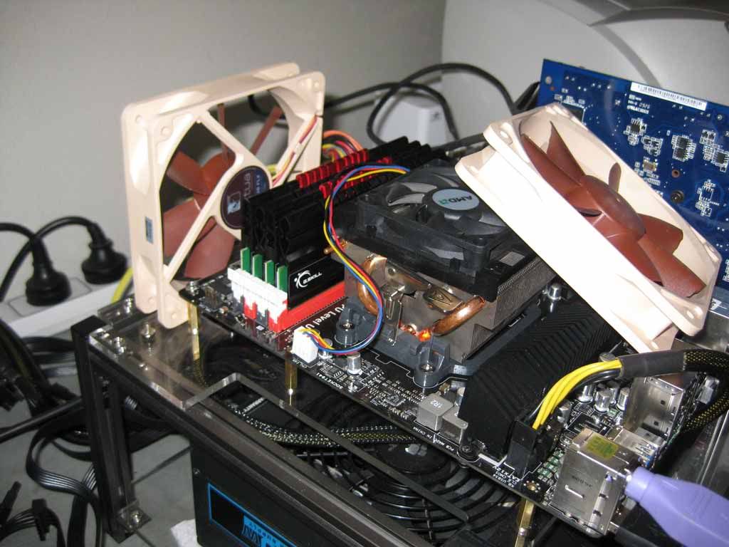

all the following results are done with air on cpu and rams, stock cooler on cpu, a few scattered noctua fans..

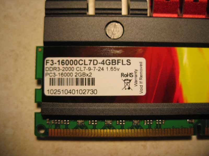

GSKILL FLARE 16000 7-9-7-24 2T

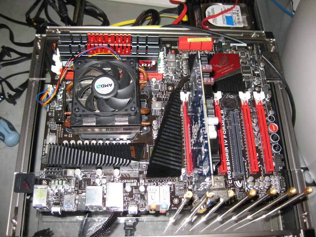

ASUS Crosshair 4 Formula

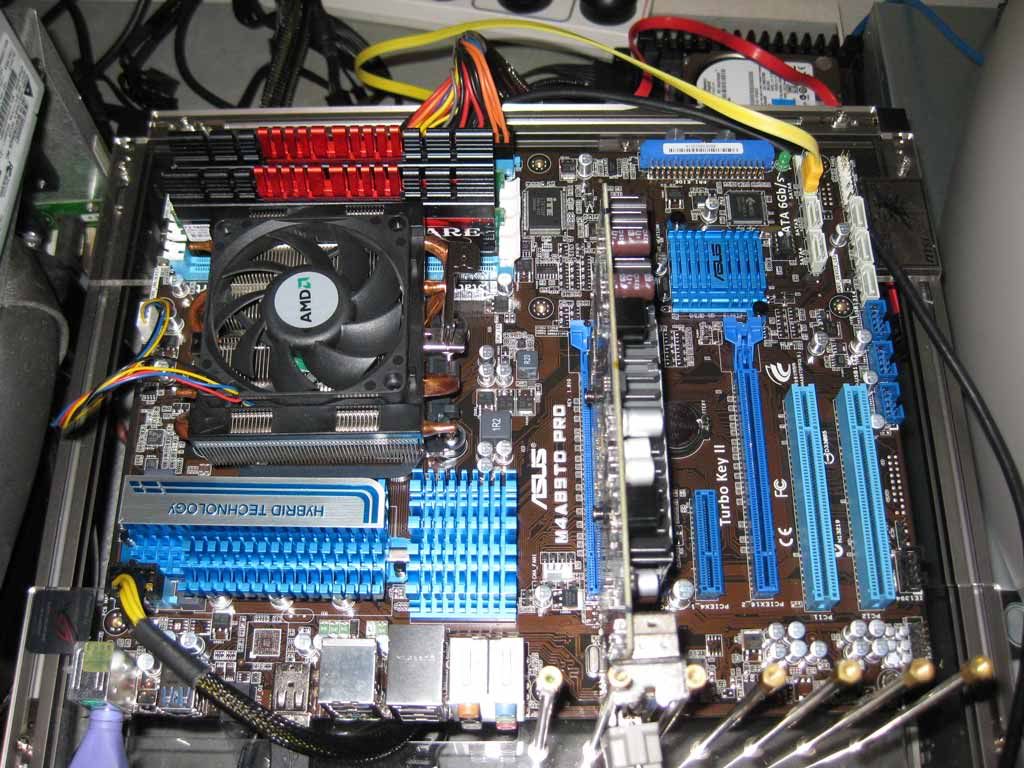

ASUS M4A89TD PRO

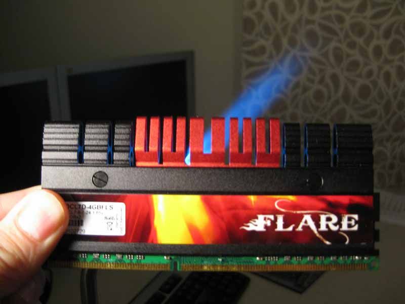

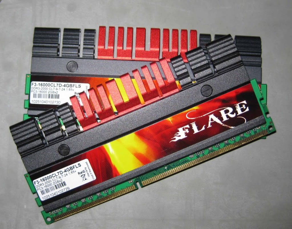

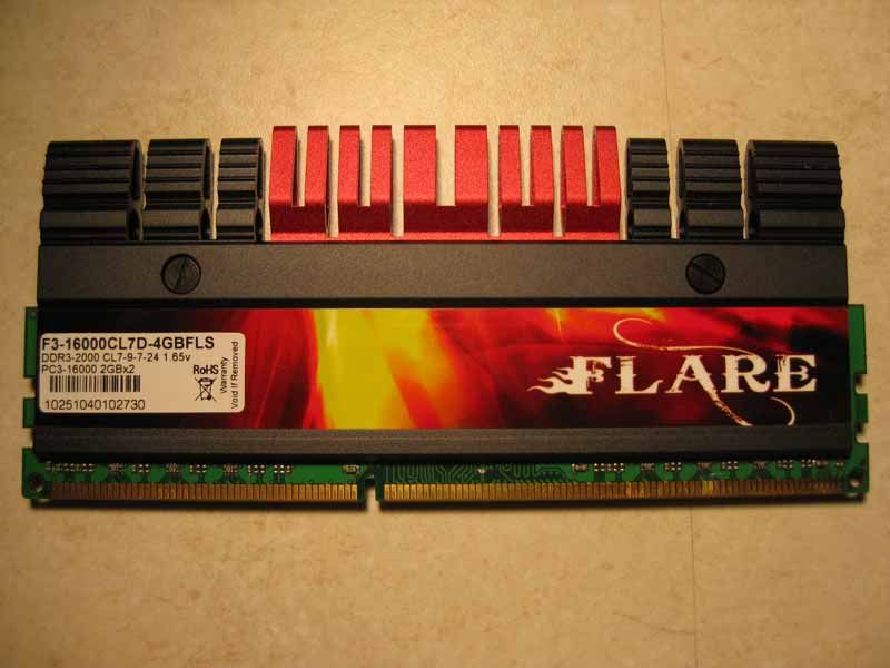

definatly a good looking module and if you are running anything asus rog or evga (im thinking p55) then they will look good in your rig..

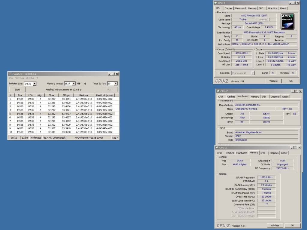

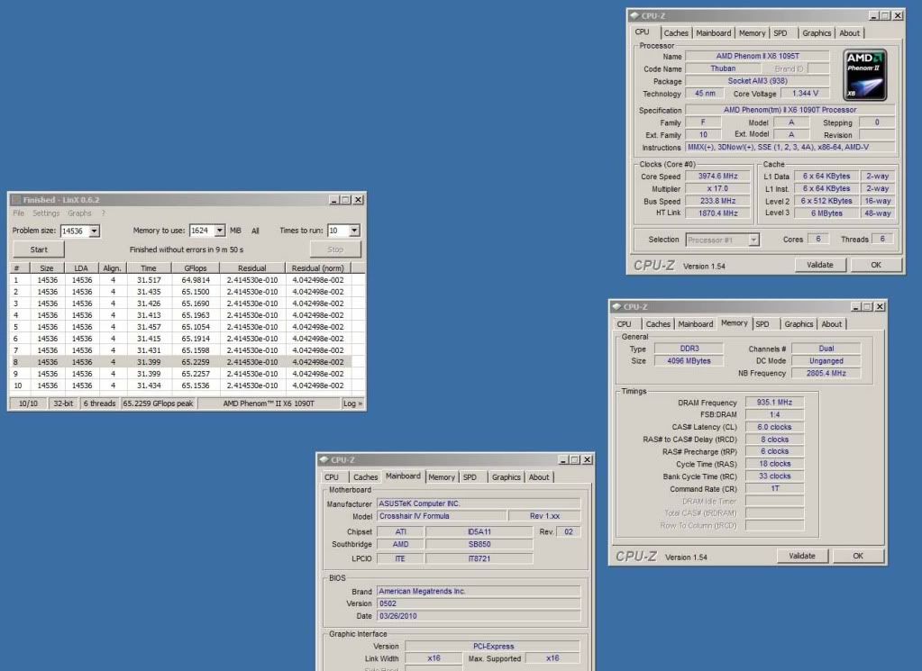

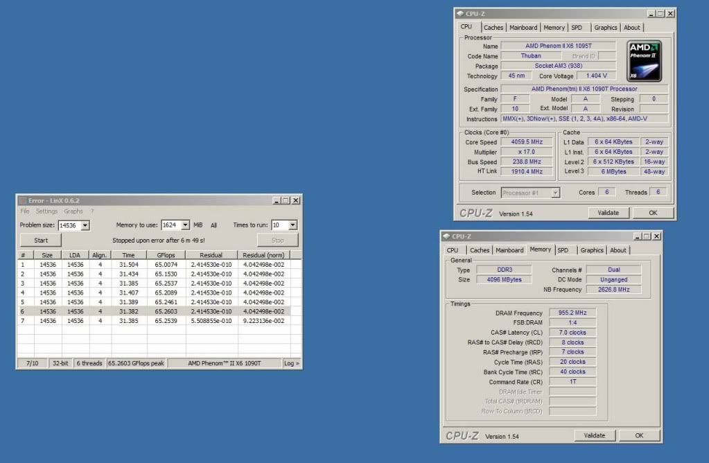

My performance results with both ASUS motherboards are identical so I will present one set of results, give or take 5+ mhz if you put these sticks in either board. My stability test is based on 10 loops of LinX at the pictured settings.
First let me say 2T is not required, if you want to run 4 modules then to push the same frequencies it might be required, but on both these asus boards I tested I could do everything at 1T, 2T gave me a few more MHz but nothing dramatic.
Max validation is 1109 MHz, but retardly cpuz has overriden my max memory validation because at a lower memory speed the CPU SPEED is higher..
7-9-7-20 1T
1075 mhz pass
1100 mhz fail
http://i200.photobucket.com/albums/a...i_1075_797.jpg
7-8-7-20 1T
950 mhz pass
975 mhz fail
http://i200.photobucket.com/albums/a...pi_955_787.jpg
this actually crashes here at loop 7 but gives a good indication that there is hardly any scaling with these modules at cas level, PSC is totally TRCD bound.. so forget your cas 6-11-6 world record, go push your TRCD instead, cas is so BH5
