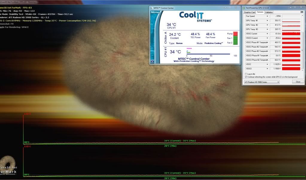

Here are the 1st REsult from Furmark. I was running it at 1920x1080 1.16V on Core and 1.15V on Ram 850/1200 Overclock
http://i620.photobucket.com/albums/t.../XSReview1.jpg

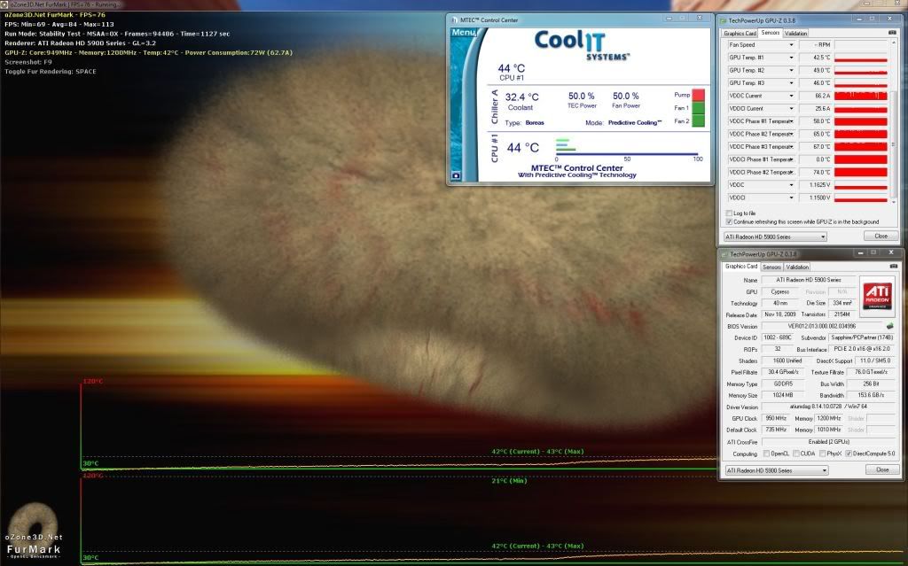

950/1200 1.16V on GPU I turned down my chiller so water would be 31c which is what most Watercool rigs will be
http://i620.photobucket.com/albums/t...review232c.jpg
