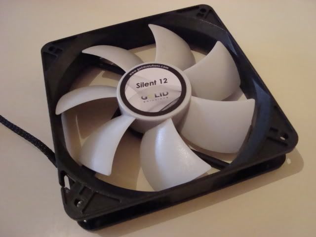

The Gelid fans certainly look the part - the white blades fit in well with most colour schemes and certainly look different to the standard black fans you see as stock in most cases

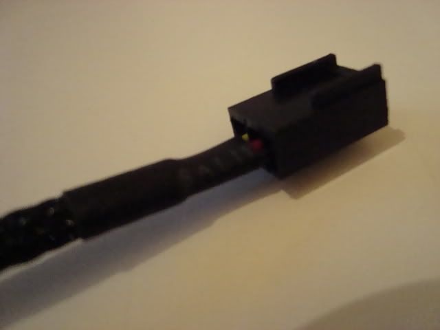

the fan cable is braided in a black braid with a black connector - I am really impressed by the quality of the braid, a feature lacking on the majority of fans in this price range

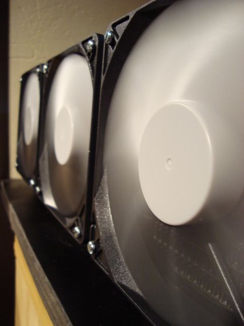

Thermochill PA120.3 Radiator with fans on test in push config [nb. radiator was outside the case]
http://i75.photobucket.com/albums/i3...7/DSC00824.jpg
this test setup is my own personal system and I have ran the Noctua NF-P12 fans on the radiator for around a month
the radiator has the three test fans in push configuration - here is a breakdown of results
3X Noctua NF-P12 after 1 hour of prime95 the CPU temperatures hit 68'C
3X Noctua NF-S12 after 1 hour of prime95 the CPU temperatures hit 73'C
3X Gelid Silent 12 after 1 hour of prime95 the CPU temperatures hit 69'C
Once again the Gelid has come in between the high performance and silent Noctua solutions
